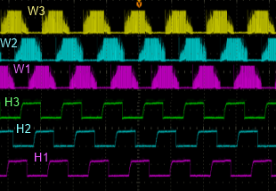

    So we changed the winding connection as
    Winding 1 connected to W
    Winding 2 connected to V
    Winding 2 connected to U
    Hall 1 conencted to W+
    Hall 2 conencted to V+

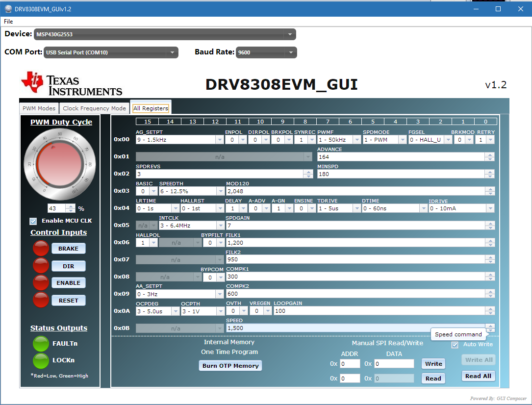

    Hall 3 conencted to U+
    and the configureation is as below
    So the motor gave full performance but start problem appeared.
    Resulting oscilloscope readings are below(labels show motor side signs).
    Please notify if you need more info.
