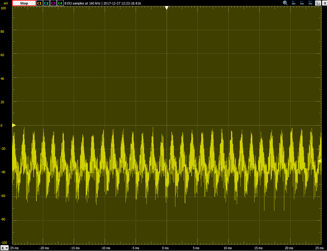

I am facing a problem with torque of motor - when I am rising current, motor starts to overheat, but torque is not increased, and is not enough.
I am not familliar with theory of stepper motors, and tuning of driver is not clear for me. Could you, please, help me with tuning?
One thing is fery confusing for me - I do not see any sinusoidal signal on my scope on current sensing resistors.
Schematics are attached.

    Can you provide a scope capture of the current sense resistor through 4 X microstepping rate steps. So for 1/32 microsteps, please show the sense resistor for 128 steps.

    One thing I see is very unpredictable behaviour of system - I can achieve very high torque, but waveform becomes sharply saw-like and motor sound is very high, and also noises in the board becomes crytical, or I can achieve thery smooth an noiseless operation with smaller torque (anyway, the torque is lowest when waveform becomes sinusoidal). Anyway, the key parameter here is TOFF, which whould be small enougth to make good torque, but big enough to make smaller noice and sound.

  • Best results aquired with:
    MODE = 2
    DTIME = 3
    TBLANK = 0x20
    TDECAY = 0x10 (default, not tuned)
    DECMOD = 5
    TOFF = 0x05
    TDRIVEN = TDRIVEP = IDRIVEN = IDRIVEP = 0
    waveform on high speed:
    Medium speed:
    low speed:
