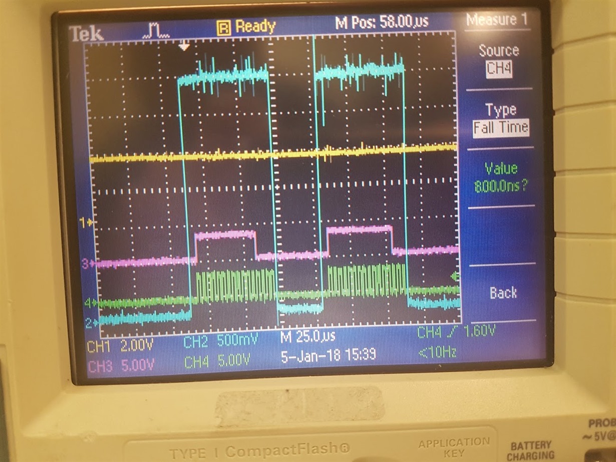

This is my probed SPI message.
1 - Yellow = SSTB
2 - Blue = SCS
3 - Magenta = SDATA
4 - Green = SCLK
I probed VCP relative to VM and I am seeing 10 V.

    The clock does not look very clean in the image. Is it possible noise is causing the SCLK to be seen as too many clocks?

    I think it looked noisy in that picture because of the scale. When I zoom in, it is pretty clean (as well as all the other signals).

    Thanks for your help. I got it working
    My data signal was being sent at the exact same time as the rising edge of the clock.
    I added the phase delay for the clock and it fixed the problem.
