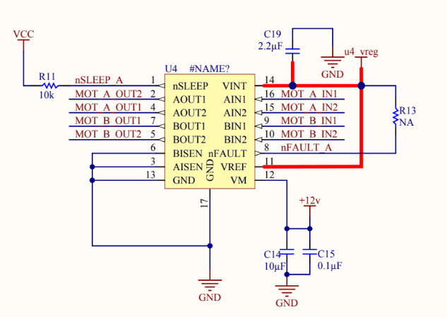

DRV8848: Drv8848 controlled by cc3200mod- is not working
Part Number: DRV8848
Other Parts Discussed in Thread: CC3200MOD,
I am using drv8848, controlled by cc3200mod, the driver is connected as shown in the schematics below,
the voltage is 12v, i don't  use pwm, every input is connected to a different port on the cc3200mod, the controller signal are working fine,
here is the problem - when I send a signal to BINT 2 al the Bout and Aout are the same, Instead of only output Bout
Has anyone had this problem and know how to solve it?
