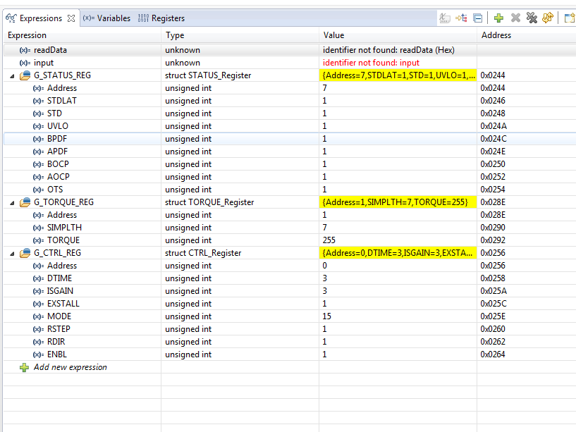

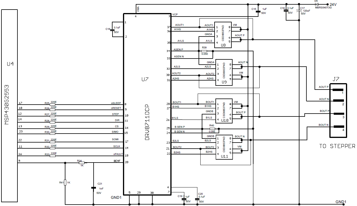

Hi all,
I am using DRV8711 for my stepper motor control project. First i tried with MSP430g2553 controller and DRV8711 evaluation kit, its working fine.
Based on that i developed new own board with MSP430G2553 28 pin package and DRV8711. I wrote code for that, my issue is Motor not run even single step.
SPI communication between DRV and MSP is working fine and other I/O's are also working good.
I attached my schematic and program also. I put pullup resistor for nSTALL and RESET pins and i removed all series resistor connected between MSP and DRV8711.
Help anyone to solve this.

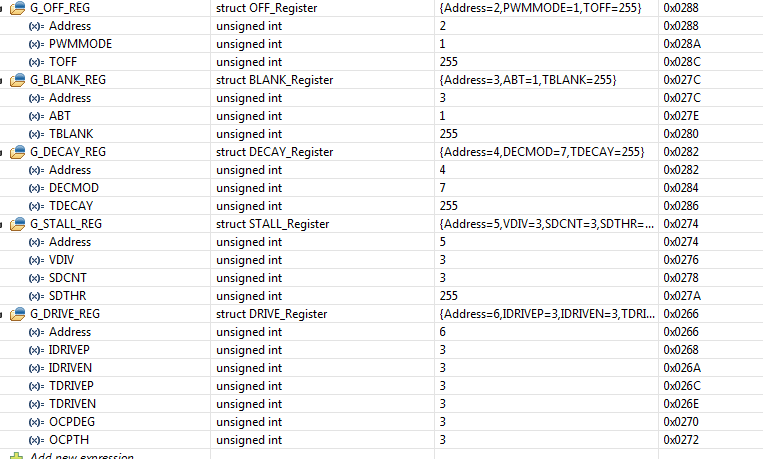

  • Hi Yuvaraj,
    What steps have you taken to compare the evaluation kit to your board?
    Do you have similar settings in your DRV8711 compared to the evaluation kit?
    Have you examined the fault pin, the reset pin and registers?
    Have you examined the high side and low side gate signals once the device is enabled?
  • Hi RICK,
    I have used similar settings of evaluation kit  in my DRV board and i also verified Fault and reset pin and all registers. Fault pin as high, Reset pin is LOW and registers status are like same as evaluation board.
    Still now, there is no MOSFET gate driven signal get from DRV8711.
    Yuvaraj

        SPI_DRV8711_ReadWrite(dataHi, dataLo);
    Yuvaraj

    Let's focus getting any FET operational.
    Please disconnect the motor and power up your board.
    Next take the DRV8711 out of sleep and confirm the regulators are operational (VINT, V5, and VCP). What are the voltages?
    If the regulators are operational and the nFAULT signal is high, enable the DRV8711 through the SPI register.
    Check the gates of the FETs. Are any FETs on?
    If not, did the nFAULT signal go low?
