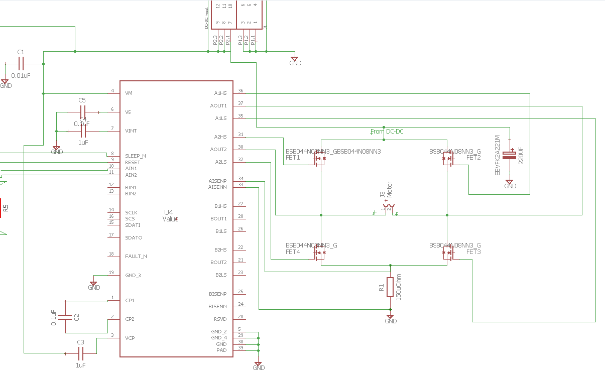

  • Here is a screenshot of the circuit, it is pretty standard because i have followed the design specs from the datasheet.
    I have attached this so you have an idea what we are looking at.
    For your additional information, the whole circuit is build on a PCB.

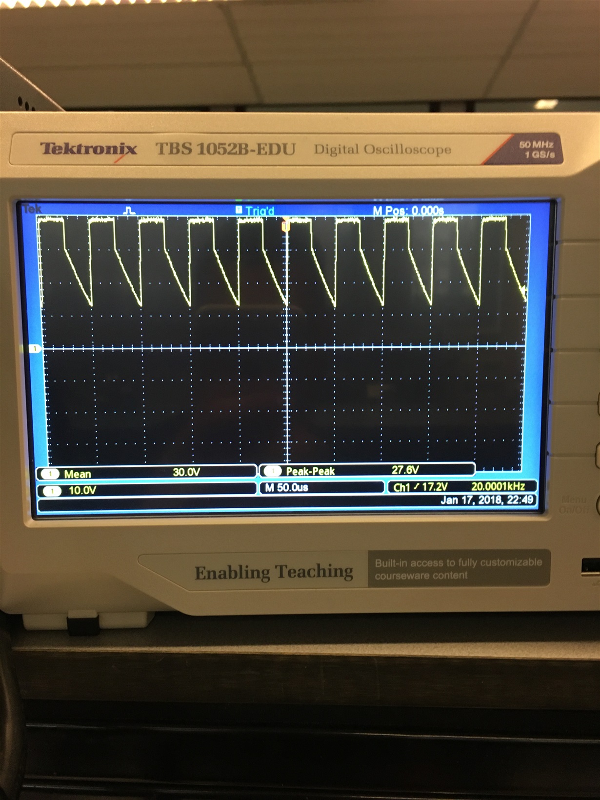

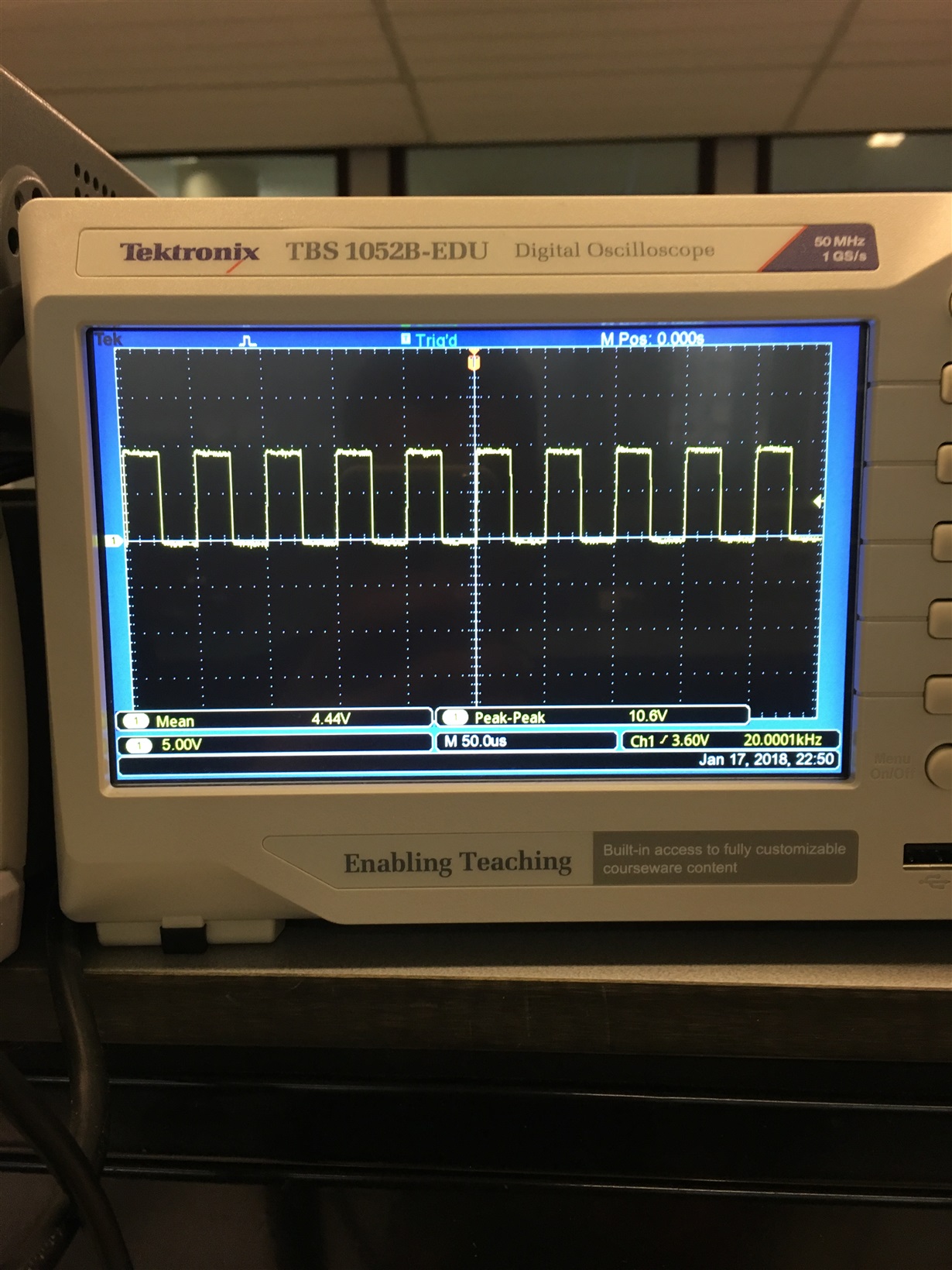

    Taking a new PCB and a new driver did the trick, i have my driver up and running except for one minor/major thing..
    The output signal on the Low side gates are as expected a smooth PWM pulse, the high side Fets seem to have a strange signal (see the attached scope pics). Could this be caused by an measuring error at the sense resistance ?
