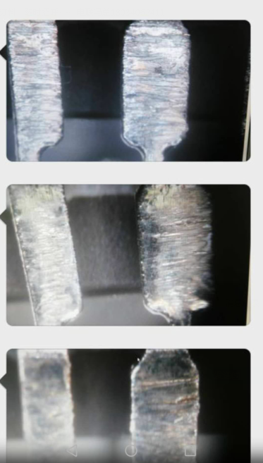

Our customer said that there are many wear scar on the parts' suface.They want to konw what  cause of the wear scar.Can you help me explain the reson?
Thank you.
The following picture is observed under the magnifier.

  • This appears to a visual anomaly that should not impact solderability. The defining specification is MIL-STD-883 Method 2009 for external visual inspection. The definition of a reject is “Scratches that expose base metal over more than 5% of the lead surface area. Exposed base metal on the cut lead ends is acceptable and does not count in the 5%.” For this package the base metal is non-plated Alloy-42.
