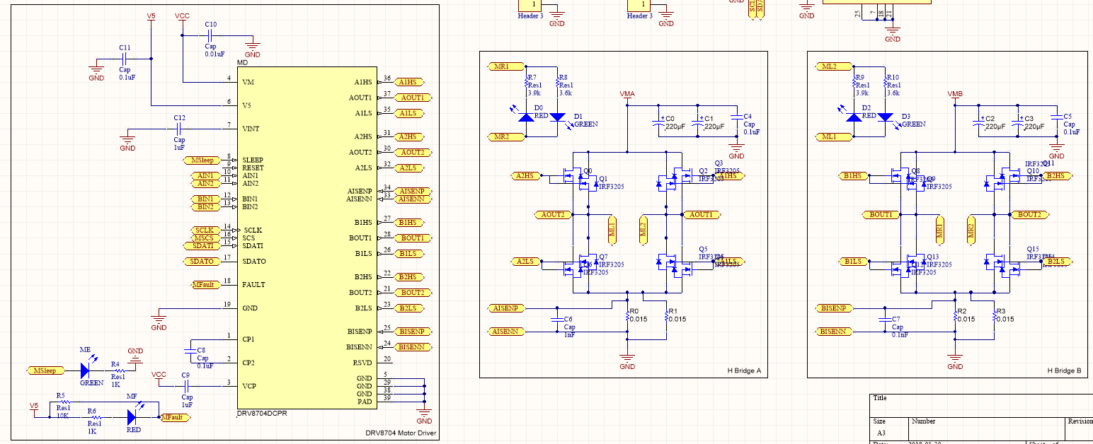

Hello!
I have an issue with DRV8704. I designed my PCB. I made all the connections as per suggested in the DRV8704 technical document
VM = 12.6V
FET = IRF3205 (Double H bridge)
Motor = Tamiya 540 with 75:1 gearbox
Current Without Load = 1.2A
Maximum Torque = 12kg・cm (6.32A/185rpm)
Problem is OCP bit set '1', fault LED is ON and motors disabled when i change direction of motor sharply. I think voltage drop across IRF3205 is higher than 1000mV, when current is not high enough to breakdown. And now i need to disable overcurrent protection, Can i do that?
