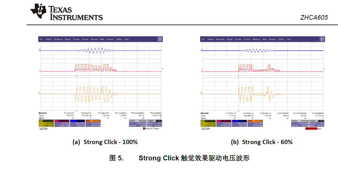

This is a Chinese version document, because I cannot find the English document. On page 13 of this document, the customer
would like to get if  the quality of the mass is different, then the figure 5 waveform will be different. Please check the below attach
for the figure 5.
  • Hi Mickey,
    1. The acceleration is measured using the DRV-ACC16-EVM.
    2. The response time is measured from when the GO signal is issued to when the outputs start driving a signal. This can be measured by monitoring the I2C lines and the outputs. The vibration strength is measured by the accelerometer mentioned in #1.
    3. The acceleration is affected by the mass, yes. This relates to physics, F=m*a, or force equal mass time acceleration. The force from the LRA will be consistent based on the type of LRA. Therefore if the mass increases, the acceleration will decrease. The waveform will still be the same length.

    Q3. For the figure 5 of the zhca605 document which is shown above, if the customer uses different LRA,
    then figure 5 waveform will be different?

    Q3. The waveform will be the same, but the acceleration magnitude will change based on the LRA, the mass, and how you mount the accelerometer.
