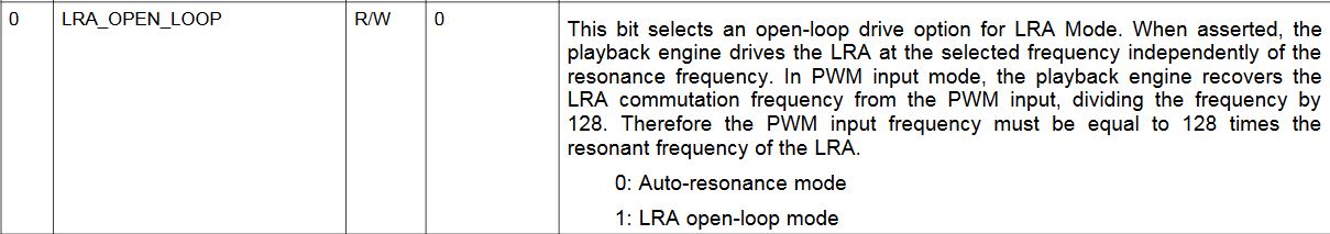

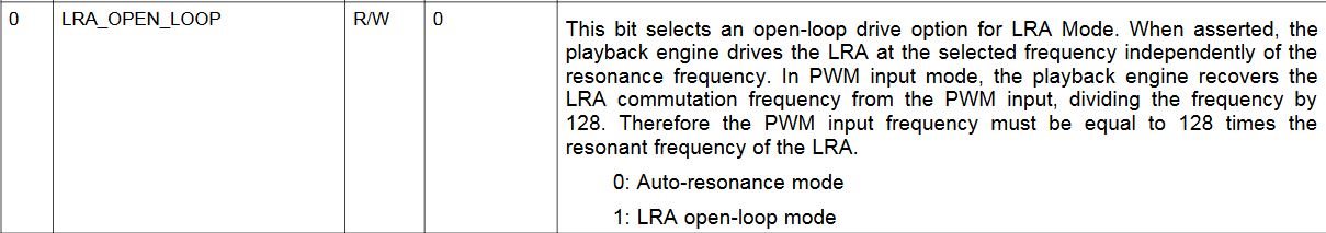

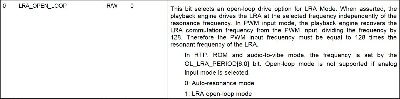

    DRV2605 is not able to work in RTP Mode while set to Open Loop LRA, it only works in PWM input mode. Perhaps you should take a look at DRV2605L for this application.
    Below you can see the differences between the two devices in Open Loop LRA.
    DRV2605:
    DRV2605L:
