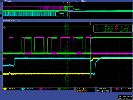

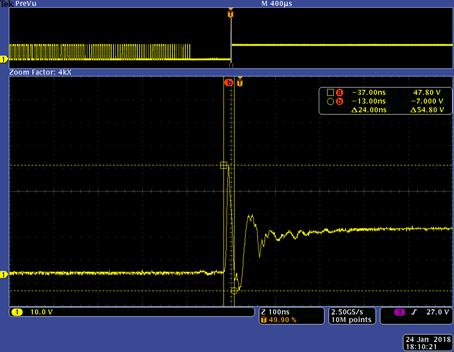

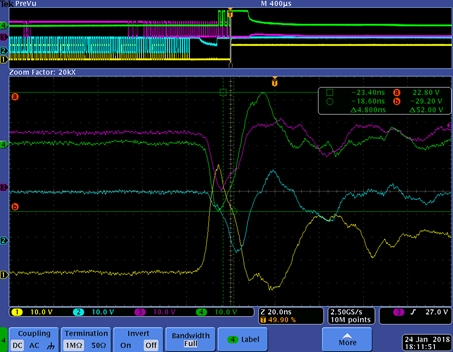

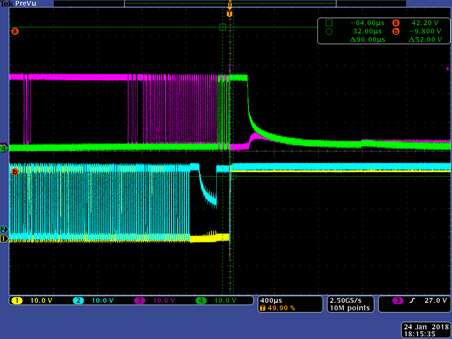

Scope measurement
- Counting four DRV8824 output pins with scopes while counting papers in frequently damaged pockets
- Trigger setting on BOUT2 pin 27V rising edge
- No counting of 300 triggers while counting by 100, Motor stopped while counting 400 from 300, and triggers on that bundle too
- Yellow: AOUT1, Blue: AOUT2, Pink: BOUT2, Green: BOUT1
- Damaged area is yellow AOUT1 High Side damaged
- The back electromotive force is measured from -7V to 47V (in another experiment, the back electromotive force is observed up to 60V)
