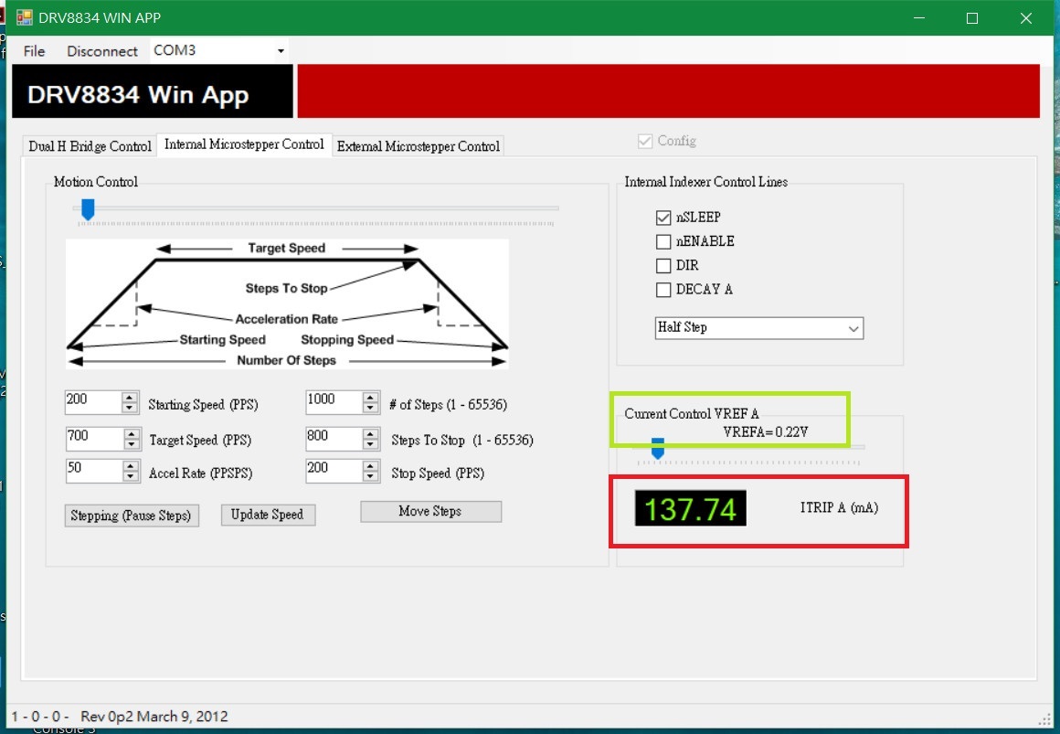

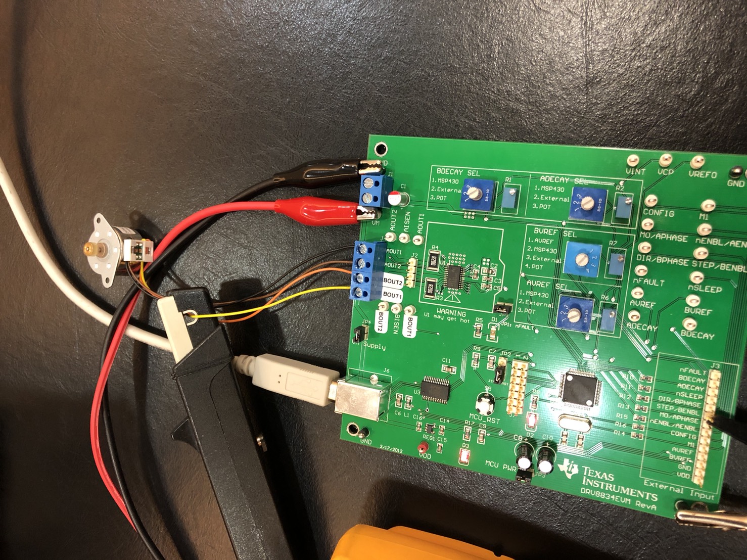

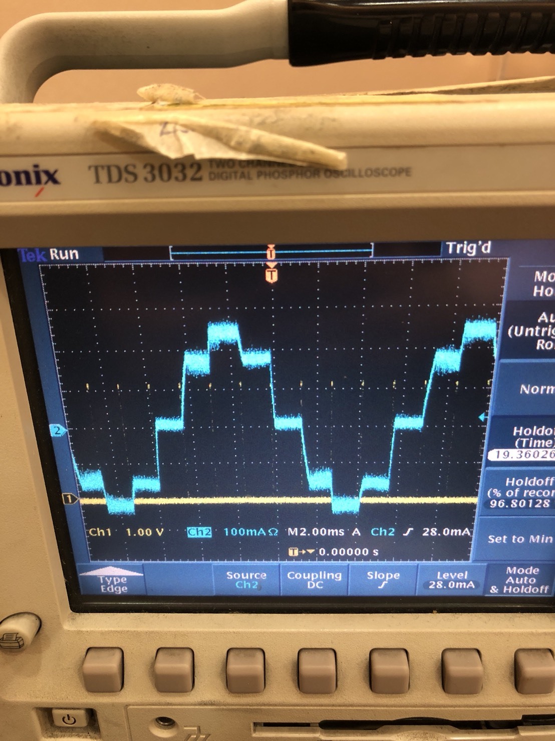

I used DRV8834EVM have a question need you help. I set AREF A to 0.22V check Motor Current is 220mA. But App show ITRIP is 137.74mA.
In SLVU701A User's Guide Equation 1 is  ITRIP = xVREF / 5 · RSENSE , with RSENSE =  0.2 Ohm. I think ITRIP should be around 220mA.
May I ask what details have been ignored? Thank for help~
