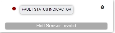

However, I could not start motor in BOOSTXL-DRV832x GUI.
I got the following status.
Regarding to status of LED1 and LED2 on MSP430F5529LP board, LED1 is "toggle", LED1 is "on".

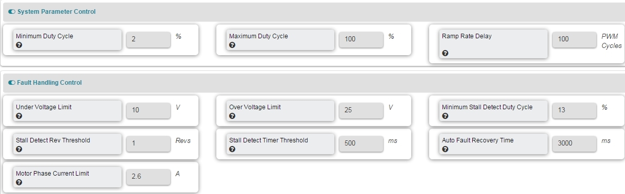

The other configuration is below.
Before this evaluation, I populated R35, R36 and R38 with 0ohm for PWM inputs.
And I set 1x PWM Mode in the GUI, and start motor driving.

    Another thought I have is about the firmware. The DRV832xx Sensored Software User's Guide says that you need to modify some parameters in Code Composer for sensored operation. Have you done that?

    Regarding to firmware, I did not modify it in CCS.  I used default.
    Should it be modified in CCS?
    I attached header file below.  Could you please point it out if there is any problem?
    TrapSensored_Parameters_Setup.h

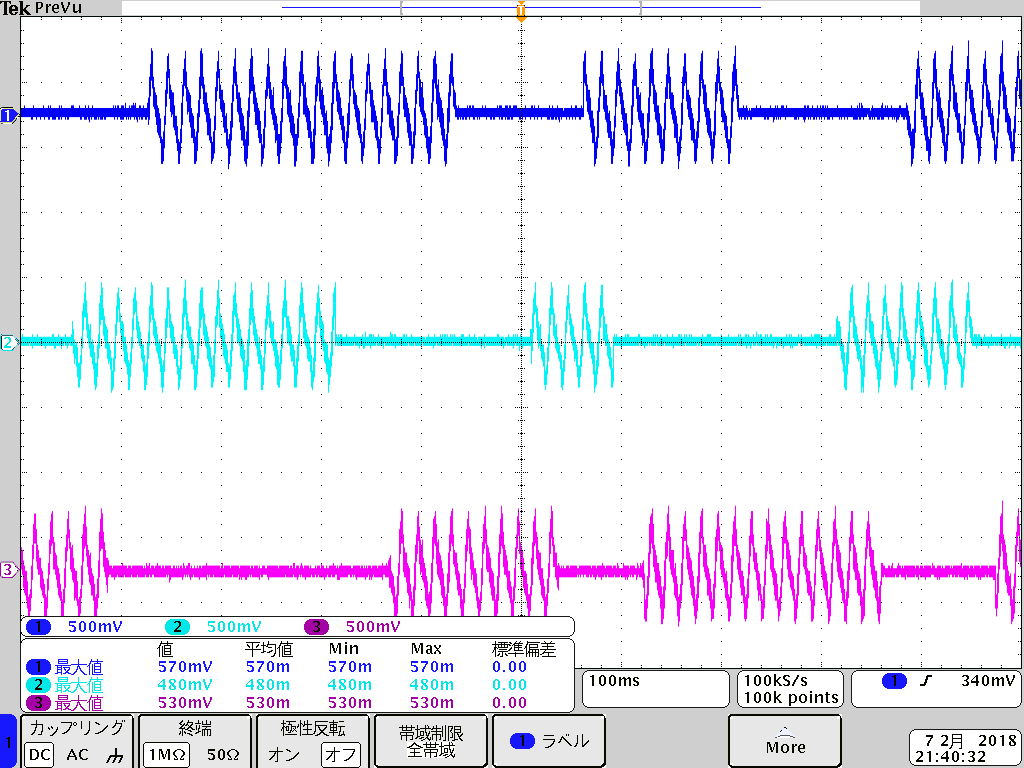

    By the way, I got the following hall signal from powering hall IC of motor, with spinning by finger.
    Do you think this output of hall is IC correct?

  • Hello na na78,
    I think you are using the correct header file, so things should be fine from a software side.
    However, those Hall outputs do not look correct. The Hall signals that the DRV8320EVM expects should be clean on/off logic signals between 0 V and 3.3 V.
    Check the datasheet for the motor or Halls to see what supply voltage the Halls need. You are correct, they may need a higher voltage supply. Double check that the sensor outputs are open drain. If they are, then you can connect them directly to the EVM because the EVM has pull-up resistors to 3.3 V.
  • Hi James
    The hall IC seems to be broken.
    I changed other motor and the sensered software worked well.
