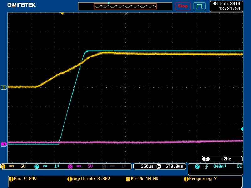

we are experiencing some problems with booting up a set of LM48580 amplifiers, which we are using as speaker drivers.
On the PCB we have seven LM48580, they are all powered by the same 5V supply.
The supply and shutdown pins are connected directly to eachother and the 5V supply.
As a supply we are using a Lab Supply with its current limit set to max (3A).
We observe, that sometimes the amplifiers do not start. It is possible to start the amplifiers quite consistently by powering off and on quickly.
Question: Can there be a bootup failure, when supply and shutdown! are supplied at the same time?
In addition we have the problem, that a few amplifiers are distorting heavily. Could this issue be related?
We have used this amplifier in different applications before, and never observed this problem. The difference in this case, to previous projects is, that we have more LM48580's starting at the same time.

    Can you provide us with your schematic and images of the signals being delivered to VDD and the shutdown pins? We have not seen any boot up issues with this device.

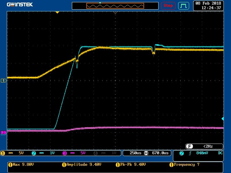

    I can however show you the supply voltage progression.
    See the two attached figures.
    LM48580_OFF: shows the progression when the amplifiers do not start
    - Yellow: 15V supply from which the 5V supply is generated with a TPS62133 step down converter
    - Blue: 5V supply that supplies the LM48580 amplifiers, there are 7 amplifiers starting at the same time
    - Pink: 3,3V supply for other components
    LM48580_ON: shows the progression when the amplifiers start properly
    The problem usually occurs when booting the system from a longer off phase. If you quickly turn the 15V supply off and then back on again the startup is usually successful.

    Do the amplifiers have any capacitors on the power supply lines? Try adding at least a 10uF capacitor. VBST should also have at least a 1uF cap. Thanks for your interest in our products, if this doesn't resolve the issue I'll reach out via email if that is okay with you.
  • Hi Micah,
    yes the amps are buffered with 10µF and 1µF in parallel on the supply side. The boost output side has a 10µF cap.
