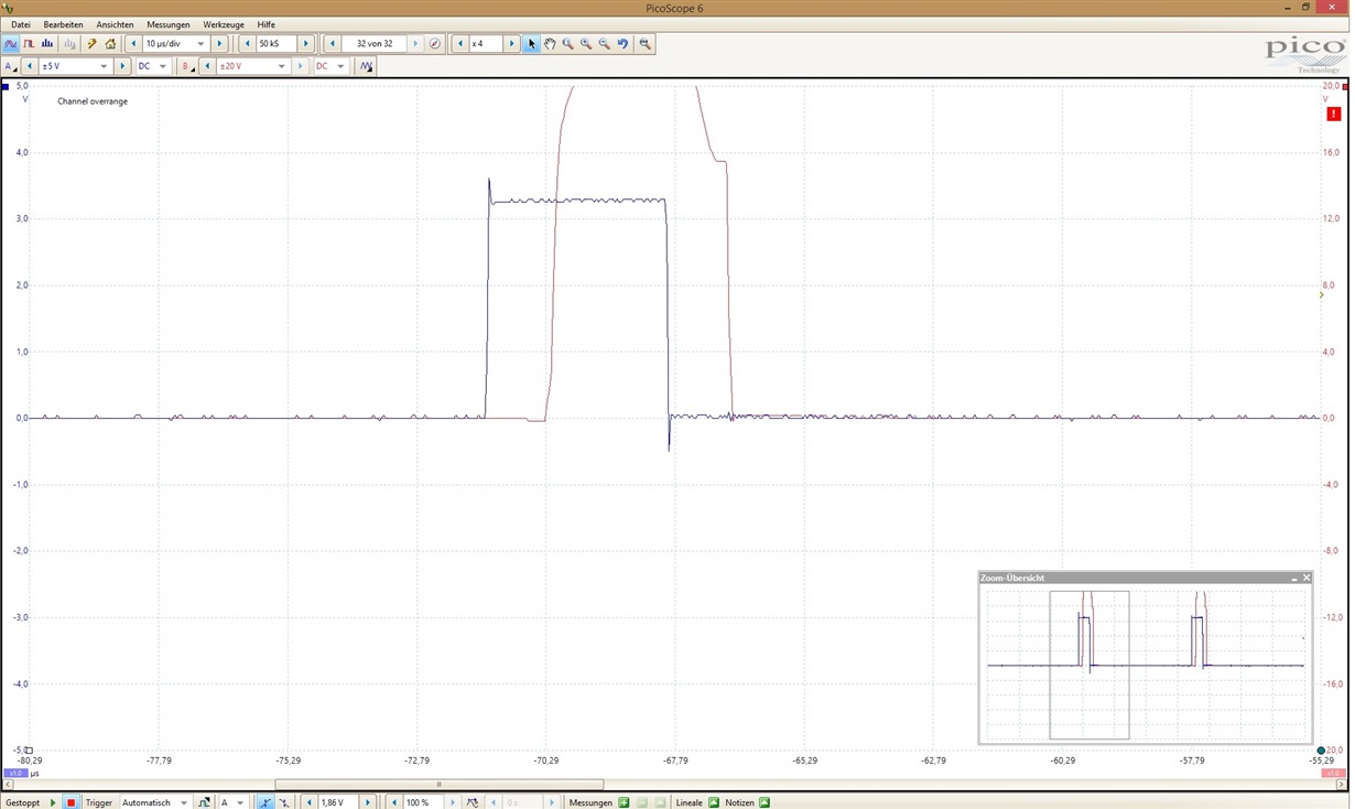

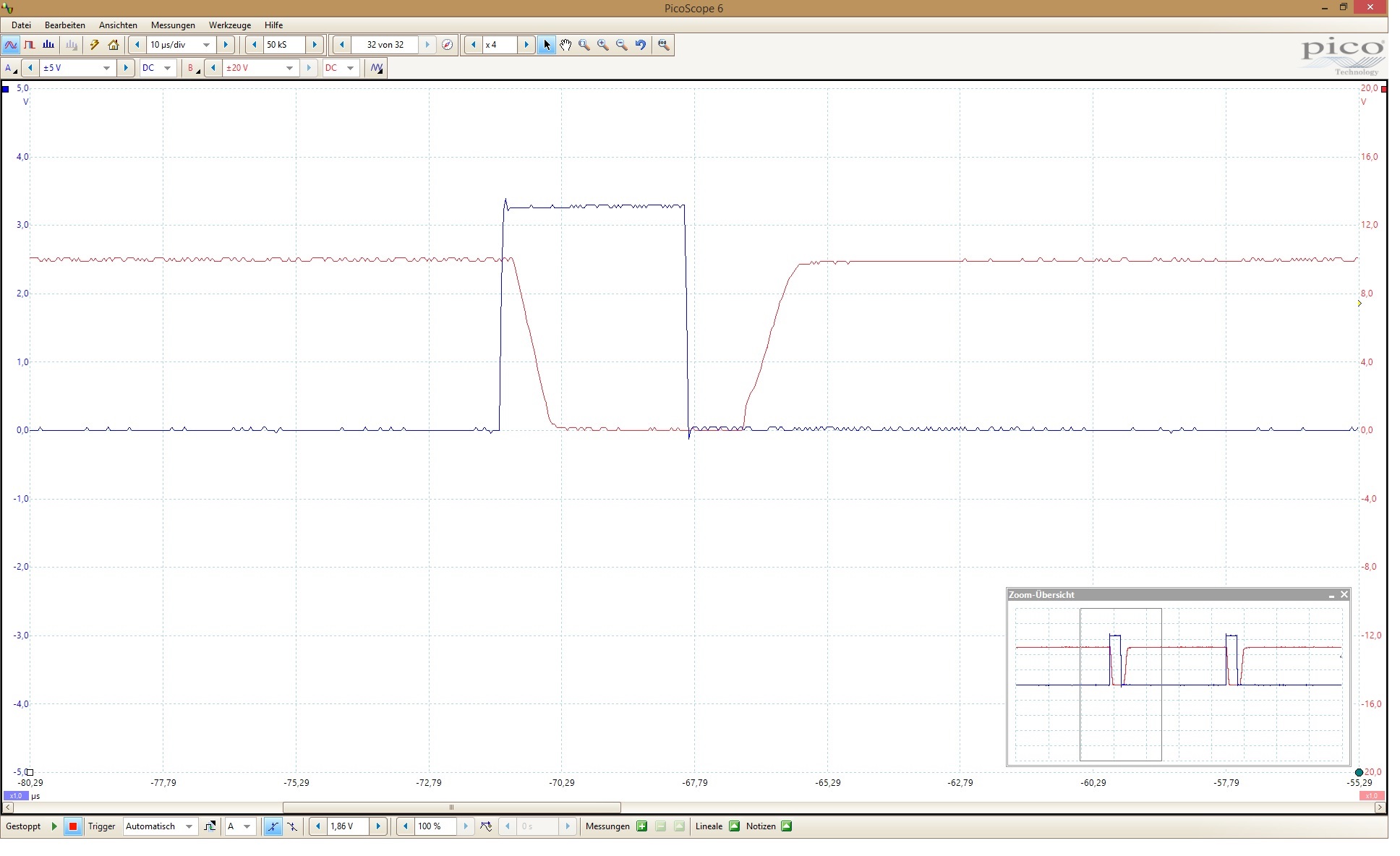

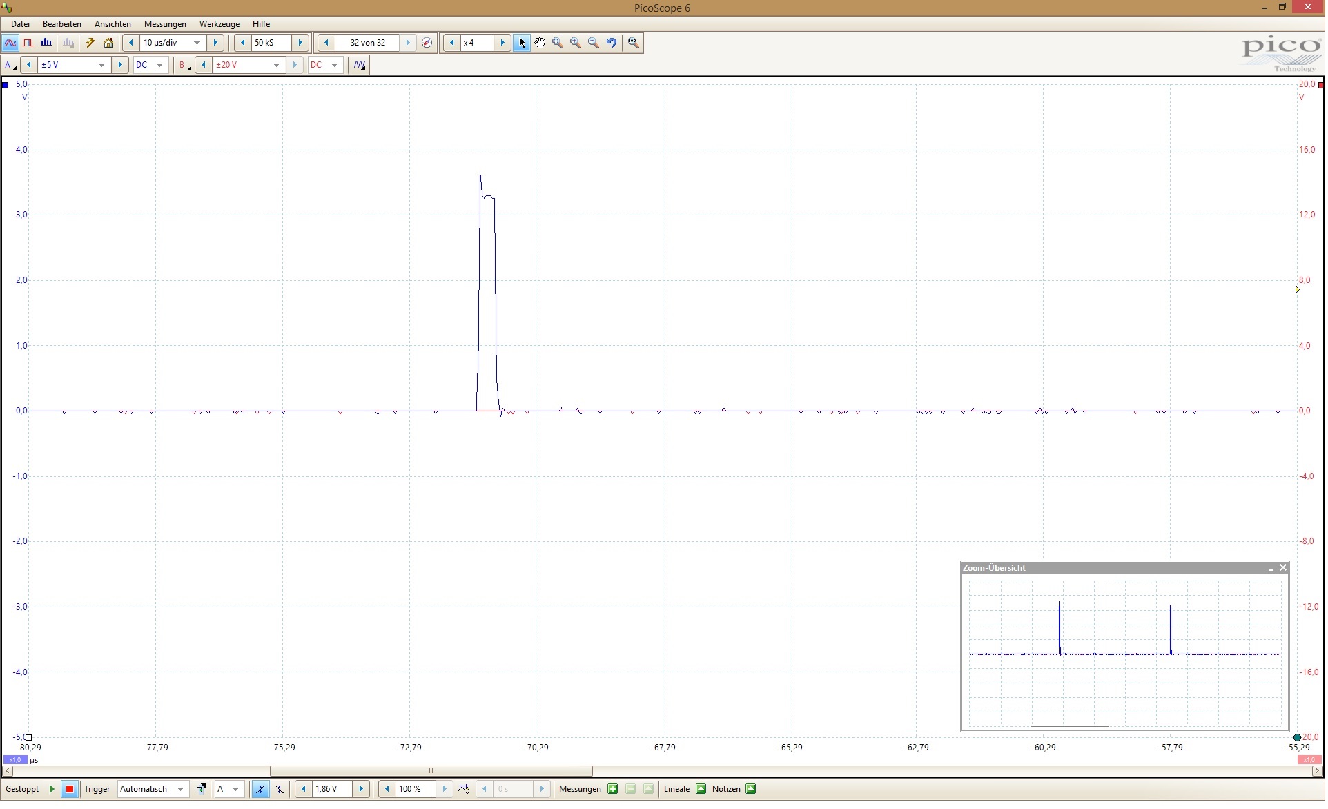

    Attached the requested Pictures. As you can see, at 10% duty cycle everything is ok.
    With 1% duty cycle, GLA is not completly pulled low. GHA is Zero all the time.
    If I see the flat ramp at GLA (10%) and the expected begining of it at GLA (1%), it seams not to discarge fast enough. What do you mean?

  • Hi Silvan,
    The DRV8305 features internal handshaking when switching from the low-side to the high-side that is designed to prevent both FETs from turning on at the same time, causing shoot-through.
    When your input switches from low to high, the low side gate driver first applies the IDRIVEN_LS pulldown current for the TDRIVEN period. Once that time has expired, the device will wait for the internal dead time (programmable via SPI as well), and then apply the IDRIVEP_HS current for the TDRIVEP period to the high side FET. If the FET fails to charge/discharge adequately by the end of the TDRIVEN/P period, this will trigger a VGS fault, and the gate drive outputs will disable.
    As you've left most of your device configuration at the power-up defaults, your TDRIVE periods are set to 1780ns, and your internal dead time is set to 52ns. From the scope captures, at 1% duty cycle, it looks like your on time is somewhere around 1500ns, so this is why the high side never even begins to turn on.
    In order to switch at the low duty cycles that you're interested in, you'll need to decrease your TDRIVE settings, but as you can tell from the low turn on/off of the FETs in the scope captures, you'll need to increase your IDRIVE strengths as well. If you're not concerned about noise at this point in time, you can probably just set these to their highest settings for now.
