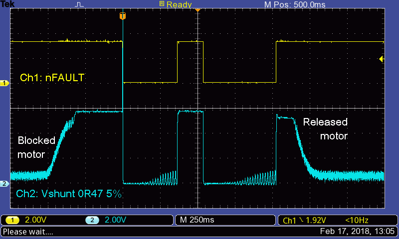

    This morning I disassembled my equipment so I could make some potentially destructive tests (everyone survived, thanks). I placed a 0,47 ohm shunt resistor in series with the motor, removed all the software safeguards, activated the motor, mechanically blocked it for a while, then released it again. Check the picture:
    From the moment the motor was blocked, the driver took almost half a second to drop nFAULT (that's why I couldn't find the signal in the first place, I was expecting it much sooner).
    The worrying part, however, is that, differently than stated in the data sheet, after some hundred ms after lowering nFAULT and cutting the output power, the DRV8840 will try to restart the motor by itself, and this attempts will continue every half second until something breaks.
    If a "false positive" overcurrent makes the driver keep itself off after nFAULT, why can't a REAL overcurrent event do the same ? What am I missing ?

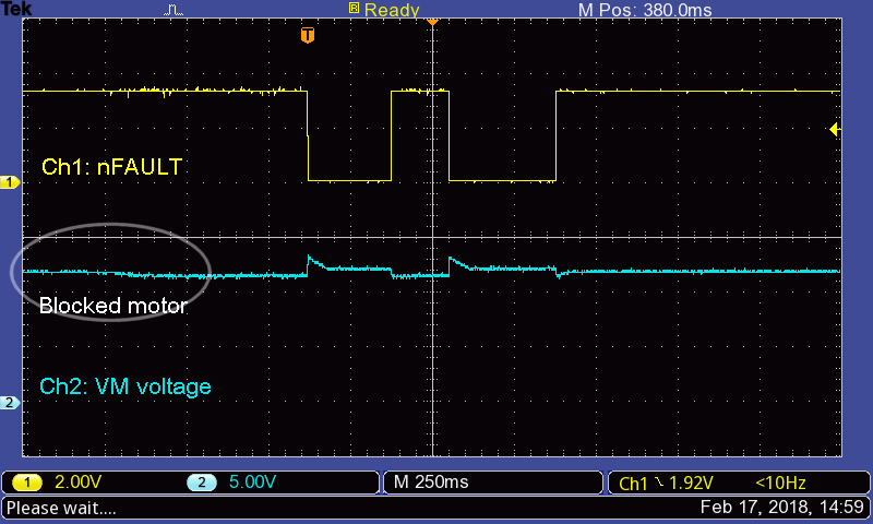

    About the VM voltage, it dropped no more than 1V when the motor was mechanically blocked (picture below):

  • Hi Alex,
    This may not be a "real overcurrent" event. The DRV8840 will enter overcurrent at 6A or greater. If the current is greater than 6A but less than the overcurrent limit, an overtemperature event will probably occur.
    This appears to be an overtemperature event because:
    1) It take many milliseconds while an overcurrent event usually takes microseconds
    2) The device re-enables the outputs after the temperature falls to a safe level, and will repeat the process indefinitely.
    For the "false positive", you may be above the limit of the overcurrent detection in one direction and below the limit in the other direction. There is a circuit for each FET, so there can be a slight variance.

    I've made another measurement keeping my SW safeguards on to ensure the motor will be shut off. That's the result:
    The voltage level on the shunt was about 3.44V, on 0,47 ohm we have a little bit more than 7 A. Data sheet says that the overcurrent protection trip level is 6 A (page 9).
    Why didn't the OCP kicked in ?
    What can I do to make it work ?
    Thank you very much
    Alex
  • Hi Alex,
    Thank you for the additional information.
    The datasheet does not say the overcurrent will trip at 6A. It says it will trip at a minimum of 6A. The actual trip value can be higher but will be low enough to protect the device.
    Your motor is marginal when it comes to overcurrent. Across process and temperature, the overcurrent may or may not trip.
    Are you trying to determine if the motor is blocked? There could be another way to do this using current chopping. Please see the application note: www.ti.com/.../slva858.pdf and reference design: www.ti.com/.../tidu302a.pdf
    Both documents are similar and describe how you can add a few components to determine when the circuit is regulating current. This can be used in many cases to identify a stall motor.
