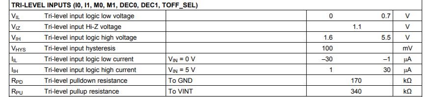

Hi, Team
Do we have accuracy data of accuracy of pull up & pull down resistors on tri-level input pins?
Thank you.
