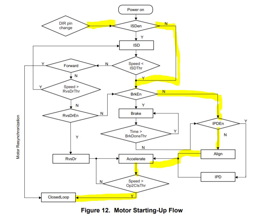

I have one DRV10983 EVM board . my motor is 14 poles /2800rmp max ,24VDC. there are some question to ask :
1) : motor can not run at low speed . I want 15_30rmp;
2): when I jump up J1 (cw/ccw) , there are very shark attack when it is runing ,can not stop first then convert diraction ;
3): there is vibrate at  first order accelerate to second order acceleration when motor start run.
best regard
hunk

    2). when I jump up J1 (cw/ccw) , there are very shark attack when it is runing ,can not stop first then convert direction ;
    Please review the settings on the DRV10983. Sometimes, abnormal behavior occurs when the brake done threshold (BrkDoneThr) is disabled because the device tries to align the motor before the motor has finished spinning (this is the yellow highlight below). I encourage you to increase the brake done threshold and repeat the experiment.
    In addition, enabling inital speed detect (ISD) and reverse drive (RvsDr) should improve the reverse drive behavior. Consult the motor sequence flow chart below and in the datasheet for more information.
