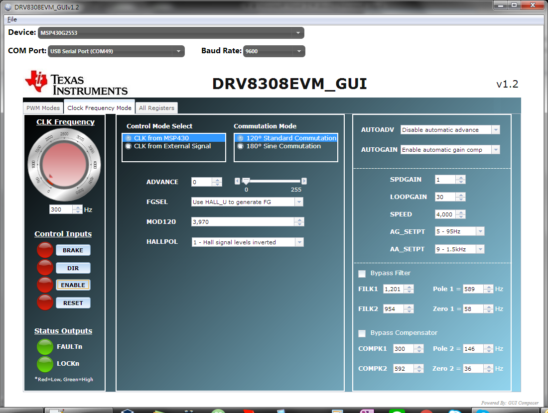

My server FAN max speed is 620Hz ,2A, VM=12V at  120° Commutation PWM mode,
When I use  Clock Frequency Mode to implement speed closed.
Fclkin=100Hz  start up is ok, then increase to 600Hz ok.
But setup Fclkin>=300Hz start up always fail.
When speed increases/decreases  not smooth and Speed ​​oscillation is obvious.
Any suggestion?
My setting as below:

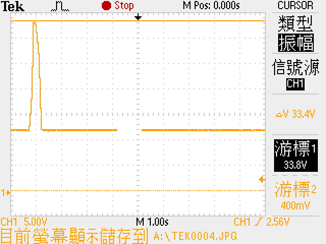

The 2nd question is that  the VM (12V) has   a very high regenerated-voltage as below picture when  FAN's speed decreased (ex: 300Hz to 200Hz).
Why? how to avoid it happen?
