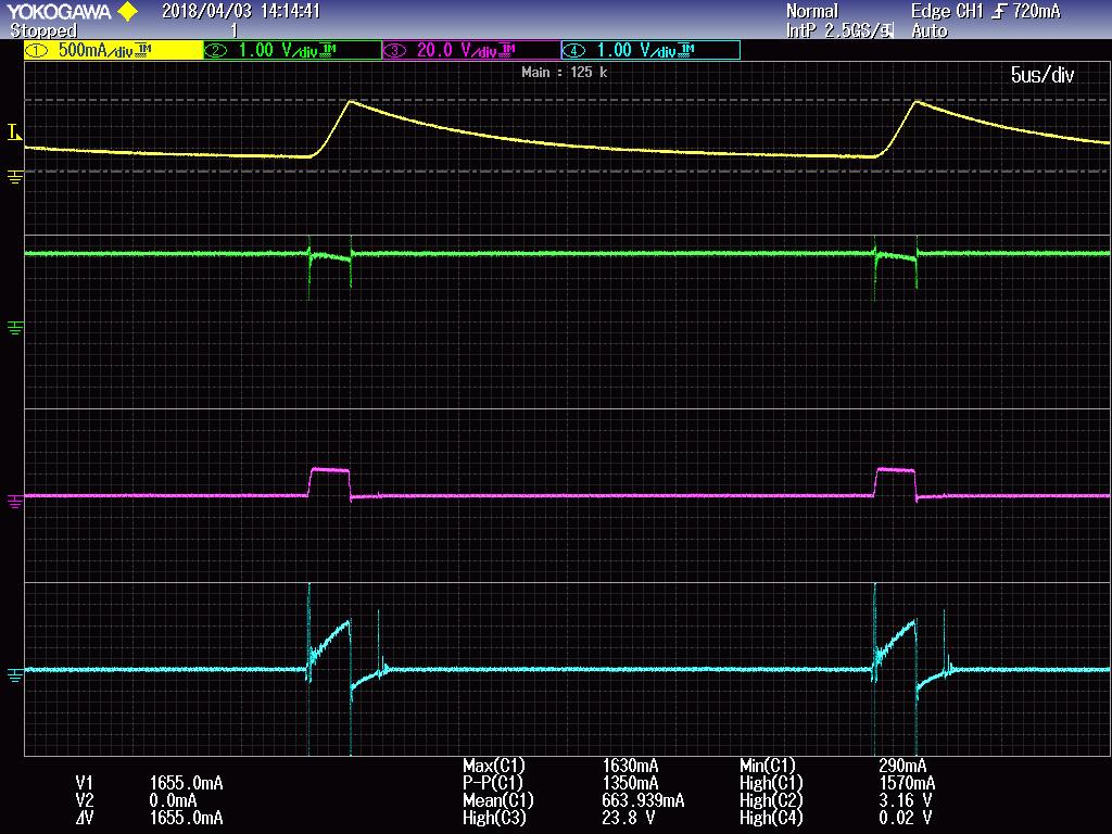

Hi Sir.:
I am verifying trip function. (Itrip =Vtrip/Risen)
But I can't get correct result.
(for example:)
VM =>24V
IN2 input signal => Logic High level
IN2 input signal => Logic Low level
winding inductance => 220uH
Motor current =>1.65A ,
RISEN =>1 ohm
Itrip  = 0.35/1 ==> Itrip = 0.35 A
When I measure motor winding current I got Ipeak = 1.65A
Why?
CH1 Motor winding current
CH2 nFault
CH3 OUT2
CH4 ISEN
Andrew
  • Hi s91240719,
    Can you provide a zoomed in scope capture of the current as the outputs are initially enabled?
    There are two items to note:
    1) The current is increasing by >1.25A during the blanking time of 2us, and reducing by ~1.25 during the off time. Capturing the initial current build up will help determine how the current regulation is operating.
    2) Please note the absolute maximum of the ISEN pin is being violated.
