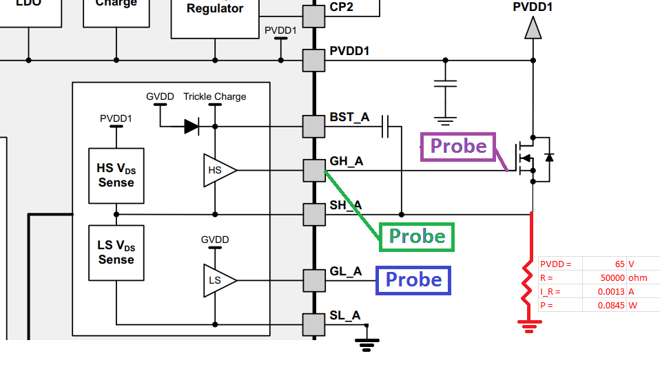

    Removing both FETs and looking at the gate drive outputs is not really a valid test because the high-side gate driver uses a charge pump which needs to reference the switching node. However, I realize you don't want both FETs on your board because of high current draw.
    Could you please put the high-side FET back on the board (please use a new one if possible). Then connect/solder a large resistance ( around 50 kOhm) from the switching node to ground. It is fine to leave the low-side FET off of the board for this test because the low-side gate driver is referenced to ground. Now take the same scope shot you took for the previous post.

  • Zhivko,
    Just pick a regular 1/4 W or 1/8 W resistor lying around the lab. Just make sure its resistance is high. I attached a picture of my proposed test setup below.
    Because of the protections and dead time control on the device, I still doubt shoot-through is the issue. But doing this test is still a good idea so we can know for sure if it is/is not the gate driver, or in case I'm wrong.

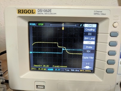

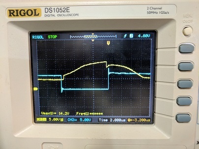

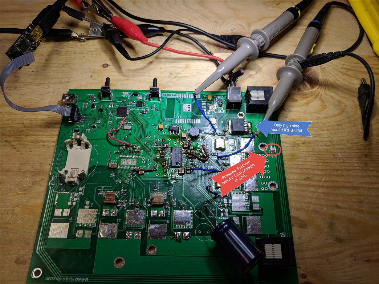

  • Hi James - here is scope picture - and animations from scope testing of SH_A to 50kOhm to GND from my modified board.
    As you might remember I am lineary changing INH_A duty, and this is latest scope traces:
    You can see that both gates are open at the same time... How is that possible? That will make short of Phase_A I believe...
    Also another thing - I left INL_A, INL_B and INL_C floating - but that should be no problem - as I see from schematic they are internally pulled low inside chip. Can you please confirm that this is OK?

  • Zhivko,
    It looks like you are measuring right at the FET gate. You might be experiencing shoot-through due to impedance between the gate drive output and your FET gate. Even though our device tries to protect from shoot-through, the chip will "think" that the FET is off, but the FET is not fully turned off because the gate hasn't fully discharged. My picture below shows a modified test setup to help confirm this. If you probe at the device GHA pin and at the FET gate, I expect to see two different signals.
    From the schematic you posted on the previous post, I saw that you have some resistors in the gate drive path that impact the way the gate discharges. One thing you can do is remove the gate-to-ground resistor and make the resistor in the gate-drive path 0-ohm. This should solve the problem, however, you may want to check to make sure the overshoot/undershoot voltage on the gate drive trace is acceptable for the DRV8302 and the FETs your are using. This overshoot/undershoot comes from package and trace parasitics.
    If possible in future layout revisions, keep the traces between the gate drive outputs and the FET gates as short as possible.
    If you want to leave the resistors in the circuit, follow the guidelines in the app note Fundamentals of MOSFET and IGBT Gate Driver Circuits. R_GATE is calculated on page 15. You can put a diode in parallel with it (section 3.4.1). Designing the Rgs resistor is described in section 3.5.

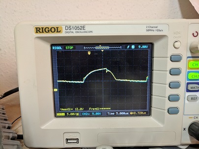

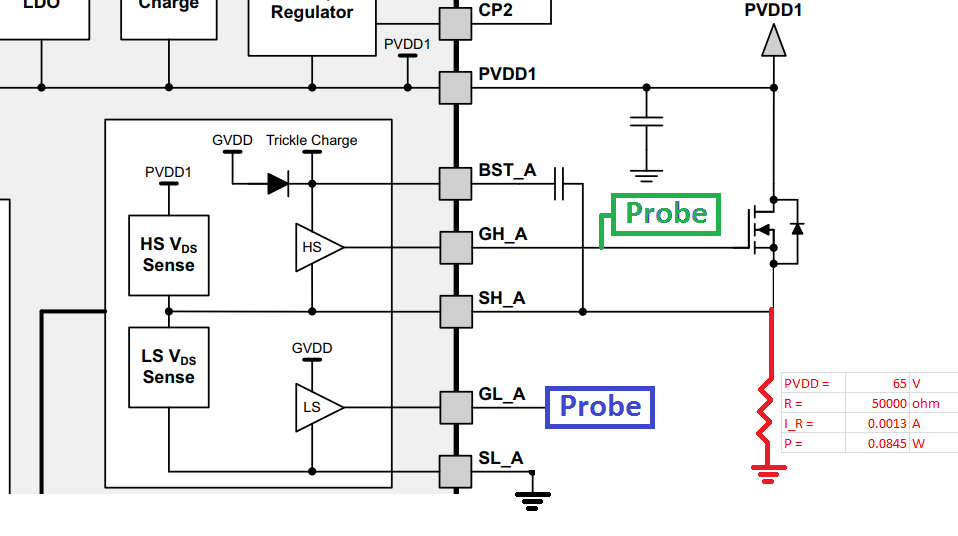

  • Hi James,
    Yes you are right I have resistor on gate of high mosfet. Unfortunately I dont have 3 probes to take 3 scope shots at same time like you proposed, but I have only 2 probes.
    Here is scope picture on drv8302 side of this resistor (yellow) and mosfet gate signal picture (blue).
    I still don't know how come that both gates are on at same time? (I made scope pictures in previous post - is it possible to know why?

  • Zhivko,
    I just realized that this device uses a bootstrap architecture rather than a charge pump architecture for the high-side gate drive. That means my suggested test with the 50 kOhm resistor might be interfering with high-side gate drive operation. I apologize for not considering that when I suggested the test.
    Another test you can try is to put both FETs back on the board, replace your 47-Ohm resistors with 0-ohm resistors, and remove the gate-to-source resistors completely. To minimize large currents on your board, you may want to use the power supply's current-limiting feature for PVDD. Also, you should only run your system long enough to take scope shots while you are debugging.
    I'm not sure what other advice I can give here. The datasheet guarantees handshaking to help protect the external FETs. Any impedance between the driver and the FETs may impact the handshaking circuits. The DRV8302 has the DTC pin to add additional deadtime when there is impedance between the gate drive outputs and the FET gates.
    Other possible problems may be due to hand soldering or other layout issues in general. Also, handling the board and components without taking proper ESD precautions may damage parts and they may operate in an unexpected manner.

  • Dear James,
    blue - pwm A
    yellow - gate of high mosfet
    pink - gate of low mosfet
    cyan - phase A
    violet - difference of yellow (gate) - cyan (source)
    You can see that when blue (pwm) drops, violet (gate to source of high mosfet) starts closing but after 0.8us there is still voltage on phase (high mosfet is open),
    but pink (low mosfet) starts to open after 0.4us - that means that at time 0.4us to time 0.8us the both mosfets seem to be open at the same time - shoot through situation
    like it is explained in drv8703-q1.
    It is obvious that low side should be opened at least 0.5us later. It seems that DTC should be in us range...
    After that - I tried with lower gate resistors - from 47 ohm I went to 10 ohm - and this seems enough that made lower gate discharged faster. So I can conclude it is VERY important to select righ gate resistors - otherwise shoot through can happen.

  • Zhivko,
    Your conclusions from your scope shot and experiment of changing the resistors are reasonable to me. It looks like having additional impedance in the gate-drive path was causing the issue. Thanks for doing this experiment and sharing your data.
    I think you will have much better luck in your application by using the Smart Gate Drive features in the DRV8703-Q1. For best performance with IDRIVE and TDRIVE, do not place any components between the gate drive outputs and the FETs. Keep the traces between the outputs and the FETs short, and make them a little wider when possible. Here is a TechNote about eliminating components with Smart Gate Drive.
