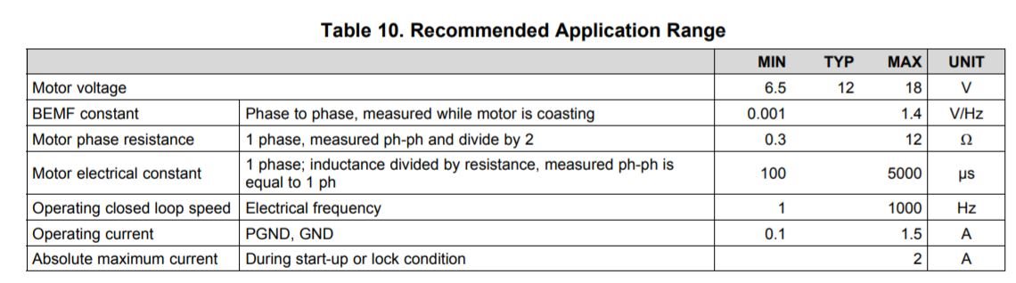

    2. Usually, the presence of a load will increase the current needed to drive at the same speed. Usually, current limit happens for two reasons
      1. The Programmed Phase Resistance and Kt are incorrect. Please refer to this post to measure them correctly
      2. The motor resistance (and probably inductance) is very low and outside of our application range. I've copied the table below for your viewing
    -Cole
