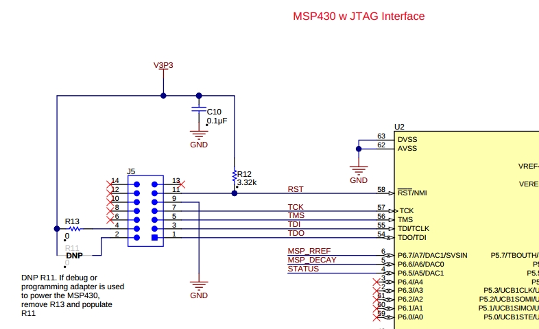

    I have pretty much confirmed every statement you have made. The only thing in which I could not find any literature regards the abillity to program the device. However in the schematic files for the DRV8886EVM I found that header J5 appears to be the JTAG header.
    The note below the header says "DNP R11, If debug or programming adapter is used to power on the MSP430, remove R13 and populate R11.

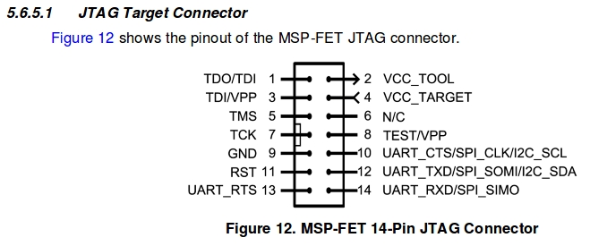

    Now, looking at the MSP Debuggers User's Guide (Rev. L) the JTAG header looks like this:
    so it looks like the UART signals are missing from the header. From the very little research I have done on these signals, they appear to enable me to simulate a serial port using the debugger. If this is true, I suppose I could jumper some wires from the MPU pins to the header to obtain this functionality. But, since I would be using the FTDI serial port during normal use, would guess that this would be available to me during the debug process.

  • Hi Jim,
    The JTAG Target Connector was used to program the mcu only. Although it is a 14 pin header, you can see on the EVM schematic only a few pins were used.
    Once programmed, the communication path is from the GUI on the computer to FTDI via USB. The FTDI converts USB to UART and sends the communication to the MSP430.
