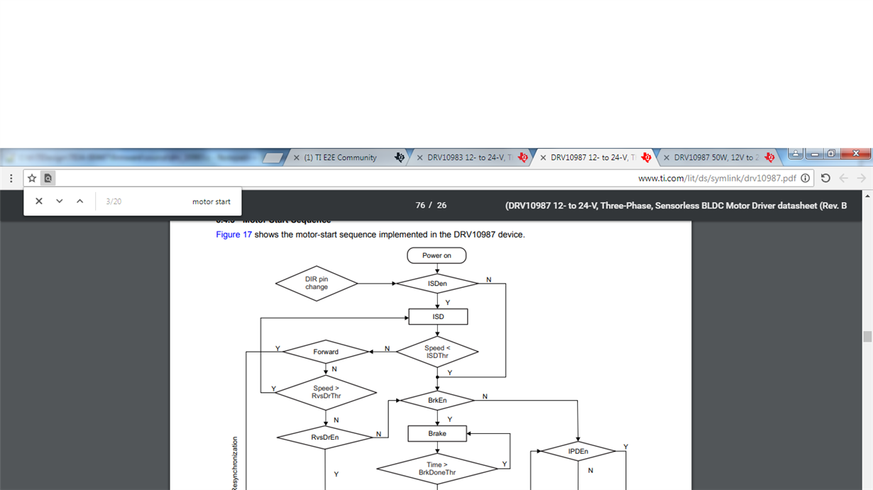

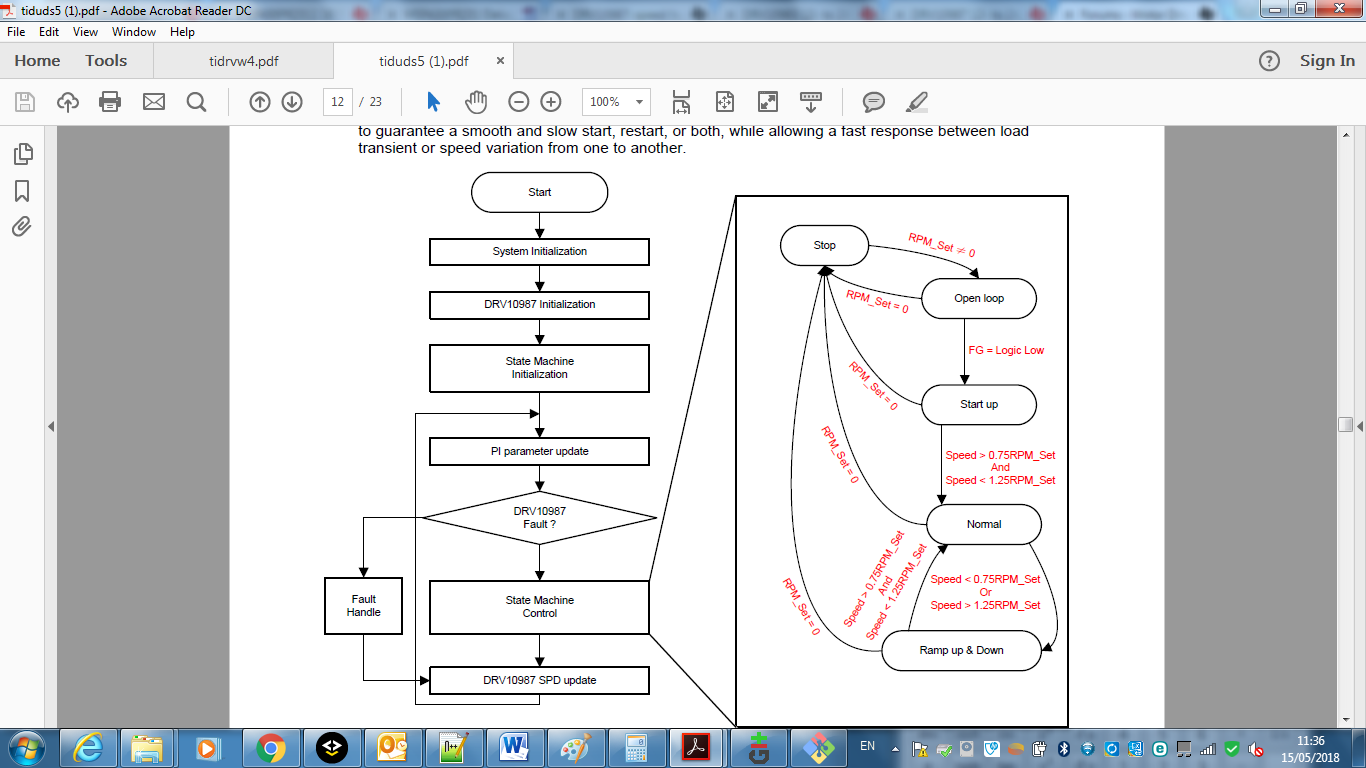

    2. in the main i need to implement the flow from the data sheet that i attached? cause you implement a different flow (attached also)

  • Liraz,
    The code says that it is reading Motor_Period_Reg fromDRV10987 and placing it in register Temp.
    Looking at the comment 2^14 (14 bits) * 1000 * 1000 / 1500 = 10 922 667. Which is the constant that is used as the longest time that the counter can count. It then divides this value by the measured count to get a number between 1 and 1500.
    The flow chart you captured from the datasheet is the process that device does as it starts the motor. You don't have to do any of this control the device does it for you.
    You simply need to provide the input PWM (or I2C) command for the speed you want to run. If that command is generated from a PI loop using the code above to get the measured period then the software will try to maintain a constant speed.
    Brian
