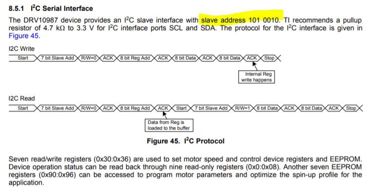

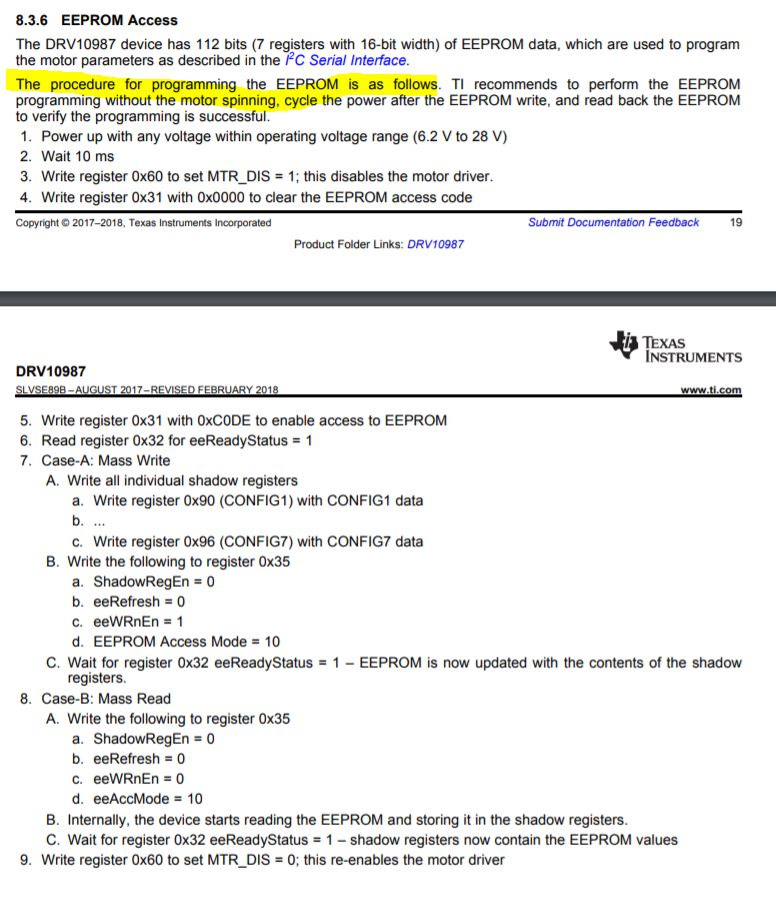

  • Hey Kalpesh,
    You do not need to have a USB2ANY to configure the DRV10983 or DRV10987. As long as you have an MCU that is capable for setting I2C commands to our device using the SDA and SCL pins, you should be able to configure the device without issue. I would only argue that it is easier for the user to use a USB2ANY and DRV10xx GUI to configure our device.
    The slave addresses are mentioned in both datasheet, the register maps appear at the back of each datasheet, and some back programming instructions can also be found in each datasheet. I've copied pictures for this information in this thread for the DRV10987:
    -Cole
