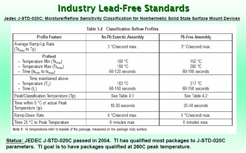

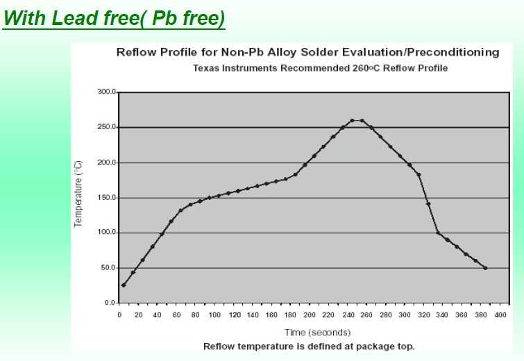

  • Hello Cole
    Thanks for your replying.
    We need a Reflow Profile data for DRV10975PWPR, and this data contains reflow temperature and reflow time.
    We also want to know how this data is compatible with capacitance and resistor reflow temperature for SMT?
  • Hello Kaine,
    Apologizes for taking so long to reply.
    After talking with our packaging team, yes, the DRV10975PWP is in line with Level-2-260C-1 YEAR reflow ratings. Since the package thickness is <1.6 mm, it also complies with the 260C peak temperature.
    They've also assured it is compatible with capacitance and resistor reflow temperature for SMT.
