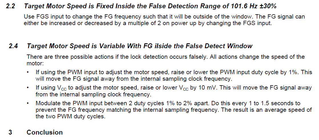

    It sounds like the DRV11873 is triggering a false lock, and this situation is well documented and presented in this app note: http://www.ti.com/lit/an/slva778/slva778.pdf
    Essentially, if the FG and RPM (by extension) are a multiple of the internal sampling clock (101.6Hz typ.) then the devie will trigger a false lock. If the motor is spinning in the 9000 and 9800 RPM range, then this would correspond to the false lock. Some customer will vary the output electrical frequency (lowering and raising the frequency periodically) to prevent this from happening if they have a specific RPM.
    Please read the document and let me know if you have any quetsions. I apologize for the inconvenice of this false lock.

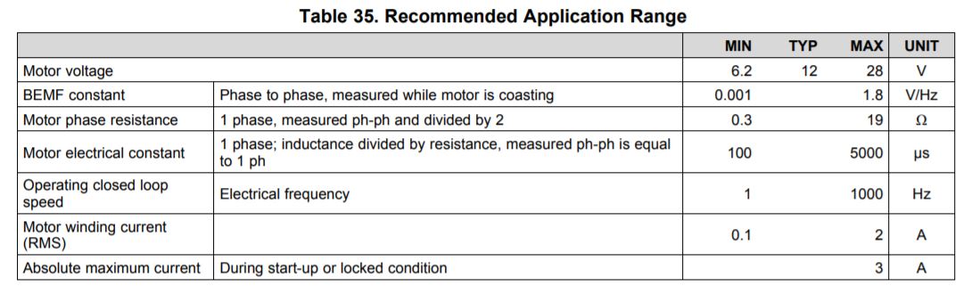

  • Hello Cole,
      Whether the DRV10987 has the similar problem ?
    Could the DRV10987 reach 10800rpm ?
    Can you recommend a suited IC ?
  • Hey Xianrong Shang,
    The DRV10987 does not have this false lock problem.

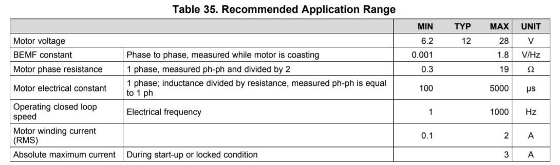

    However, I will say that the DRV10987 might have a hard time obtaining this RPM. According to the electrical frequency to RPM equation, this RPM seems to be outside the capabilities of our device:
    f_electrical = RPM*(n_poles)/120
    f_electrical = (10800)*(12)/120
    f_electrical = 1080Hz
    As shown by out table below, the max electrical frequency (operating closed loop speed) our device can output is 1000Hz. Using the equation, 1000Hz will put the motor at 10,000RPM.
    Unfortunately, TI does not have a suitable replacement to obtain this high RPM. However, I encourage you to check if this driver might be suitable for you.
    -Cole

      So,  only the DRV11873 can reach 10800RPM. But I refer to the recommendation of slva778, the false lock still existed. Why?
    the PWM is 12KHz, the Vcc is 12V, the FG is 900Hz, the duty cycle is about 55%, the motor still grind to a halt at 9200RPM.

  • Hello Xianrong Shang,
    Apologizes for the late reply. Unfortunately, it sounds like your test results lead to fine tuning of the system.
    To give context into what is happening, RD is a pin that indicates the motor is blocked or stopped with an external force when it is high, as you've previous mentioned. It monitors FG and see if it toggles or remains constant at a frequency of 101.6 Hz +/- 30%. As a result, if the device gets the motor to a certain RPM and the triggers RD when the motor is not blocked or stopped by an external force, then the device is triggering the false lock.
    I've restated this is information because the duty cycle and VCC levels have been adjusted and are still causing the RD to go high when the motor is not blocked. This indicates a false lock. The only way to fix a false lock is to continue to adjust the duty cycle or VCC. I apologize because I know this is not ideal and I apologize that we don't have any other drivers that meet your needs (yet).
    To answer your question, changing VCC levels will affect speed. This is because VCC is how the driver delivers current to the motor. Thinking about a R,L, and V_BEMF motor model, more applied voltage (VCC) will mean more current.
    However, millivolts are probably not enough to change the RPM of the motor significantly. This depends on your system's requirements. If you are curious, monitor FG and see how changing VCC from 12.01V to 11.96V affects the electrical frequency of the system.
    -Cole
