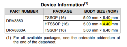

  • Hi Rick,
    Thanks very much for your recommendation. If I create a footprint for the PWP on my board, can I use the PW if it turns out that I don't need the additional 130mA of output current (i.e. is the PW a "drop-in" replacement)? The package outline drawings for the PW and the PWP in the datasheet appear to be identical except for the thermal pad of the PWP. But the table on the first page of the datasheet states that the body size of the PWP is smaller than that of the PW, which implies some mechanical difference between the PW and PWP packages.
    James
  • Hi James,
    Yes, the package appears to be the same. For further confirmation, you can go to www.ti.com/.../pinout-quality
    Scroll down to find the .bxl files and use the ultralibrarian tool to convert the schematic symbol and layout footprint to one of many CAD/CAE packages.
    You may have to work with your vendor on how to use the board for both thermal pad and non thermal pad devices in both a prototype and higher volume environment.
