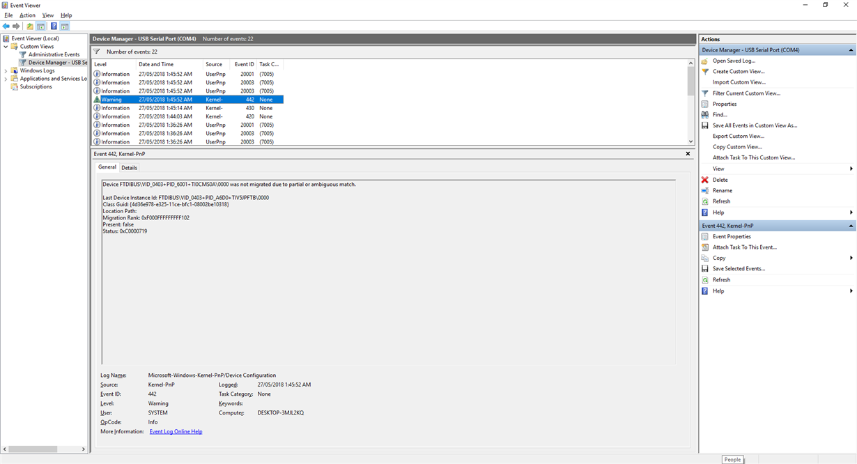

    I found this warning in the USB Serial Converter:

  • Hi Dimitar,
    Sorry for the delay. Can you try uninstalling and re-installing the USB device? Hopefully this will correct your communication issue.
  • Hi Rick,
    Thank you for your reply.
    I tried reinstalling the USB driver  several times. I did that and on a computer running Windows 7 PRO. No success.
  • Hi Dimitar,
    I am referring to the device, not just the driver.
    In the device manager, open the Ports (COM & LPT)
    Plug in the EVM and identify the COM port used.
    Right click the COM port and Select uninstall
    Check the Delete the driver software for this device
    Unplug the EVM
    Plug in the EVM to re-install
    If changed, note the new COM port
    Open the GUI and use the pulldown menu to select the correct COM port if necessary.
