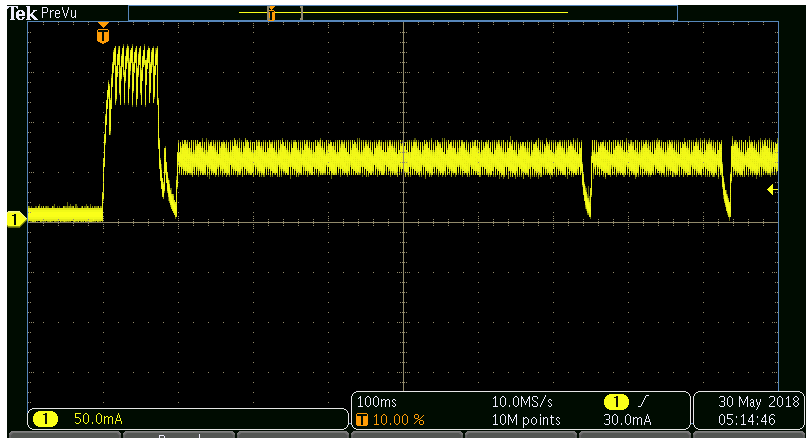

DRV120: Current drop to zero after peak and then attempts to recover back to the HOLD level.
Part Number: DRV120
Other Parts Discussed in Thread: DRV110
Rpeak = 100k
Rhold = 100k
Rosc = 200k
Ckeep = 1uf
Vin = 24Vdc
Cbypass = 4.7uf/50v
Fluid Valve = Parker 002-0010-900
Current probe TCP0020
Current drops to zero at random intervals. Any tips?

  • Hi Chad,
    I see the issue you are having. Is your setup the same as before, where there were no issues at F_PWM=5kHz and 10kHz?

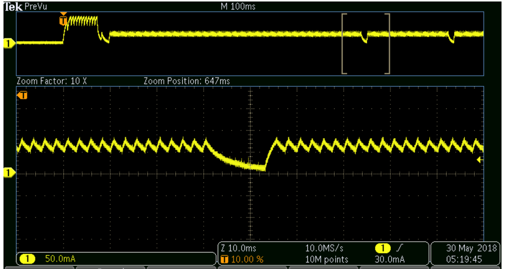

    I'm curious about the low-frequency oscillations in the current, particularly at the peak current. Can you post a close-up of the peak current waveform and the OUT voltage, showing one cycle of the low-frequency oscillation?

  • Hi Grant.
    I went back to the 20kHz osc. just so we can see the initial problem. I'm thinking the inductance is messing with the PWM behavior during the HOLD state. That being said, and upon reading the description on how device works during HOLD, I fail to understand why the HOLD state is failing. I'm juggling several design flows at this time. If you have some suggestions please let me know and I tweak the design.
    The wire connection to the fluid valve 22awg, stranded wire, 4 inches long.
    Chad
  • Hi Chad,
    May I suggest one change to your schematic: use a fast recovery diode for D1. It could be that the diode's slow turn-on time is causing voltage spikes on the OUT pin, which is only rated for 28V. The STTH2R06 diode used on the DRV110 EVM has the same SMA package as the MRA4004 you are using.
    I would still like to see a close-up of the low frequency current oscillations. Having low frequency oscillations is not uncommon for the DRV110, but typically the peak current of each oscillation (not to be confused with the peak current setting) should be constant.
    Grant

  • Grant,
    The fast diode did the trick, I had a MURS160T3 laying about.
    Using the same resistor values (20kHz osc), only change was the diode.
    The circuit does sing at about 10kHz during the PWM hold state of the design.
    Chad
  • Hi Chad,
    Excellent! I'm glad that switching the diode solved your issue.
    Regarding the 10kHz ringing, you can try changing the PWM frequency between 15kHz and 25kHz to find a more stable value.
