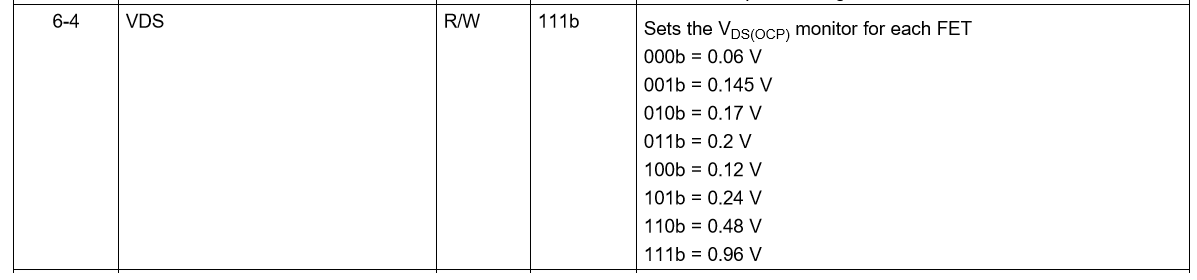

Dear, Sir.
Regarding VDS Threshold Resister Setting as below, My customer is feeling strange the value
shifting from 011b=0.2V to 100b=0.12V.
They would like to double-confirm the description is really correct.
Sorry to ask this kind of matter, but hoping to get your advice.
