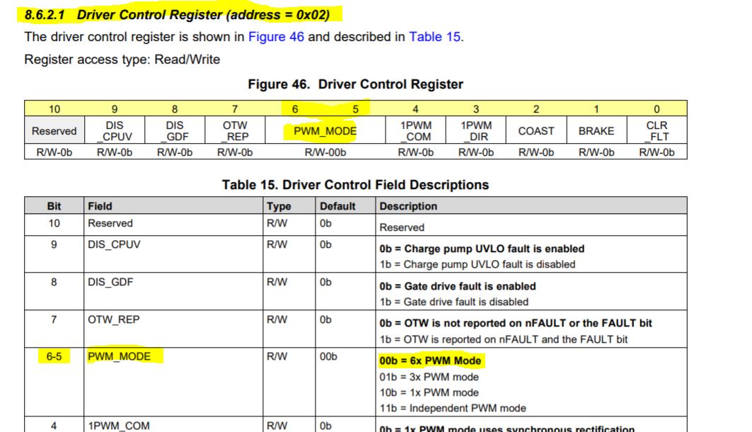

Part Number: BOOSTXL-DRV8323RS
Other Parts Discussed in Thread: DRV8323, TMS320F28069M
I am doing some testing with the BOOSTXL-DRV8323RS and TMS320F28069M launchpad.  When I set the ENABLE pin high, the high side gates all go high even when I am commanding them low.  The low side gates are commanded low and stay low.  This happens before even setting the DRV8323 up over SPI.  So, it is in the default 6x PWM mode.  Is this the expected behavior?
