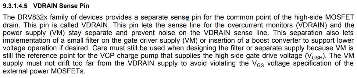

Could you let me ask some question about connection of VM and VDRAIN?
Our customer are going to separate VM and VDRAIN because they would like to put the filter on VM.
They are concerned about UVLO when the ripple voltage is large at low input voltage.
If VM and VDRAIN is separated and the filter is added to VM ,it may have some voltage differences between VM and VDRAIN in some cases.
How much is that difference acceptable? I think it depends on external MOSFET. If it so, how do I calculate how much can it be acceptable?
Also if we add some filter on VM , what should we care about?

    It is not recommended that the Vm and Vdrain be separated. The device is designed to operate with these supply lines being only one supply line, as the Vds monitors and Vgs can be negatively affected.
    When Vm is above Vdrain, you need to have enough voltage on the gate and drain of the high side to still switch the FET. Therefore, calculating the bridge operation with voltages on Vdrain and GHx will net you the answer. No issue here
    When Vdrain goes below Vm, you have to be careful about the Zener clamp diode on the high side, basically, the diode will not function correctly if the delta (Vdrain - Vm) is not large enough.

    On the datasheet, it is mentioned about the separation of VM and VDRAIN and the filter.
    If we would like to add a filter on VM,how can we add the filter? and how can we configure the VM and Vdrain line?

    >> Vm < Vdrain. It is suggested that they stay the same, due to the case when Vm < Vdrain. You can separate them, but you have to watch out for the clamp diode operation. Recommended the difference between when Vm < Vdrain be 4 V or less.

    >> Separate the Vm and Vdrain lines if you wish to operate with them separately. The filter can similar to the one found on our DRV8305-Q1EVM User's Guide (Rev. A)'s User's Guide. Filter found on Page 14 as Optional PI Filter. Please note that EVM is designed for up to 45 V. While the DRV832x device works up to 60 V.

    >>>You potentially violate the Vds protection based on the minimum clamp diode voltage of 15 V.
