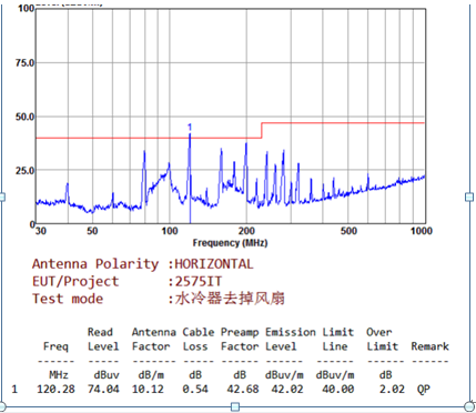

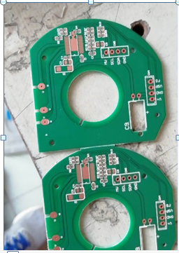

Hi,Could you  help to give same suggestions how to reduce the EMC if uses DRV10983, besides, Which frequency band may cause excessive EMC during DRV10983 work?
The customer's product exceeded the EMC when the water cooler (water pump, DRV10983 driver board) was used to perform the EMC test, test results is above
