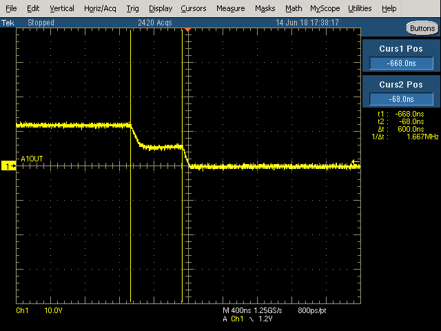

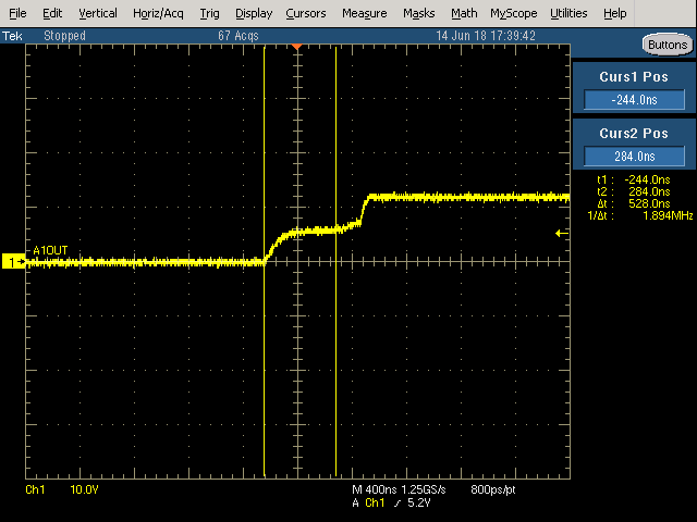

  • Hi user5237878,
    The rising deadtime  of DRV8841 is about 528ns typically.
    The falling deadtime of DRV8841 is about 600ns typically.

  • Hi, Betty
    Thanks for your aply.
    Above graph is good for me. I'm trying to replace IC which is similor to the SM72295 with more Low voltage IC.
