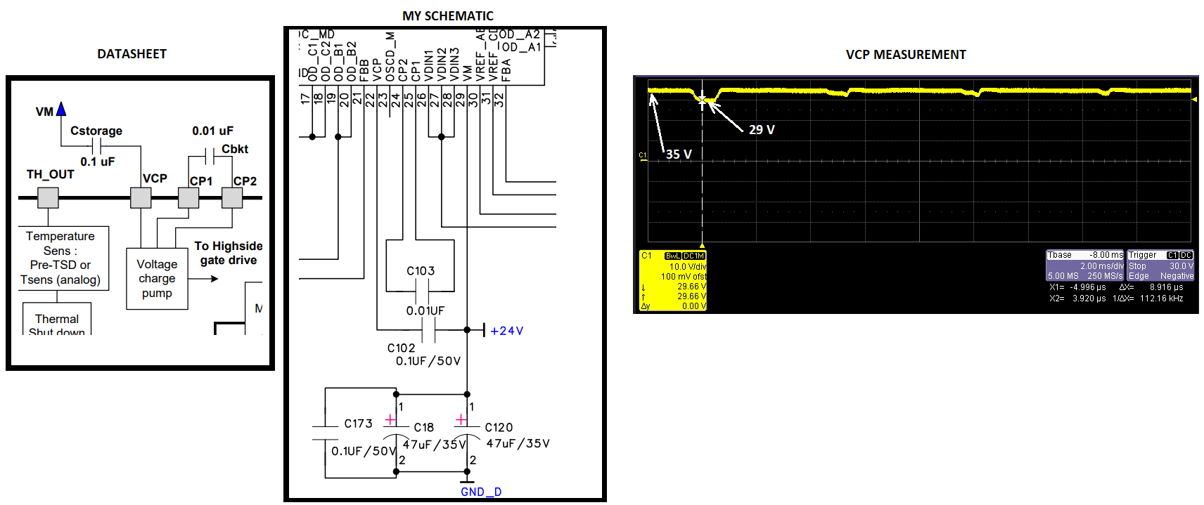

  • Thank you for the response.
    I measured the VCP voltage and it's usually steady around VM+11V. However, I noticed that when the motors are running, sometimes I see a fast spike that drops the voltage to VM+5V and back up to VM+11V.
    The circuit has been designed to the datasheet spec and I'm not sure what is causing VCP to fluctuate.

    I am feeling drop from +11V to +5V is a little high, but I do not have data on my hand. One thing I may try is to increase VCP cap from 0.1uF to 0.47uF. If VCP is not high enough, we could not fully turn on high side NMOS FET, then high side Rdson gets higher. It brings high Ploss and heats up IC.

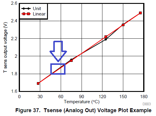

    I also removed the 3.3V pull up and measured TH_OUT as an analog output. When the motors are not moving TH_OUT is 1.8V and when the motors move TH_OUT is 1.9V. It does not look like it is getting hot according to the Tsense plot in the datasheet.
    Since TH_OUT is not going beyond 1.9V when TSD is happening, does it mean the chip is falsely triggering a TSD?
    Any other ideas/suggestions??
    Thank you
    It is strange that TH_OUT shows lower temp, but you verified it was shut down by TSD.

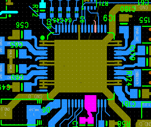

    I am guessing that power pad connection could be potential root cause. If power pad connection is not proper, die can be heat up quickly then TSD happens. This device requires the power pad is well soldered down to GND plan through via.

    From our design, we do have a connection to the grounding pad. We also have a large pad and some runoff traces to try and get some of the thermal rise under control. We also take measures to ensure that the pads are correctly joined to the solder.
    The problem is happening really quickly, and the thermal rise shouldn't be in the millisecond range. We also used one of your older chips, the TPIC70600 and are not seeing this same issue occur (it also uses this same pad and structure).

    It is very wired. Good PCB layout shuld have range of 20-30C/W. So we can handle 2.x W range normally. If you run all 4 motor drivers at the same time, it may heat up quickly by exceeding 2.x W. My suggestion is to reduce motor current or disable some of motors.
    Unfortunaely i do not have ideas anymore. I believe this is not just one part issue which is broken.
