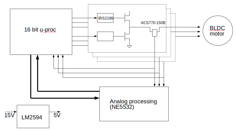

Just wanted to share my success building a system for sensorless detection of the rotor position of a bldc / pmsm motor. (I hope this is allowed). This with the rotor standing still and from power-up, so with no history present in the microcontroller.
I get the same 0-359 degrees electrical rotor position info as you would with a resolver. While the rotor position measurement is running it is possible to apply phase current for generating torque.

    Wondering if you could share what TI components you used in this design and the reason for choosing them?  Perhaps even a block diagram and description so others could benefit from your design expertise. And advantages over this method of position detection over other methods.
    ~Leonard
  • Hi Leonard,
    Thank you for your reply. There is not much TI content, it is more that I would like to know how this compares to the Instaspin. I've heard on Endless-sphere that Instaspin can spin a motor from standstill without using hall sensors or a resolver ? I have tried to build something similar (starting from scratch):
    Basically what I built is a processor feeding into gate drivers feeding into a classic output stage. From there the power signals go through current sensors into the motor. The signals from the current sensors go to the processor in two ways, straight and via some analog processing. There is no motor voltage feedback.
    With the above schematic (and the appropriate code) the system can detect the electrical rotor phase of the BLDC. The first video (see previous post) shows that the system can generate similar output as a resolver, 0-359 degree info (and not just 6-stepped). It does this by measuring the motor inductances. The second video shows that it can do this while also supplying phase current (to generate torque).
    The advantages ? No need for a resolver or hall sensors to detect the rotor phase, but still capable to provide torque at standstill and low rpm (even from a cold start, so powered on from completely off with no memory about any previous rotor movements)...

  • Hallo Bas,
    I am really impressed with your development!
    I have seen in your videos that you use only outrunners. Do these motors have this periodical variation of reluctance like the inrunners with buried magnets?
    What kind of commutation do you apply? Is it possible with six-step commutation?
    In advance, thank you alot for your answer and of course, for sharing with us your achievements.
    Kind regards,
    Stratos
  • Hi Stratos,
    Thank you very much for your kind words. Yes, the motors I use have the periodical variation in reluctance.
    Unfortunately, as the whole algorithm is private and unprotected I cannot say anything about it...
    Bas
