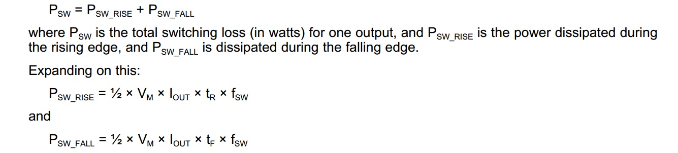

 The customer try the thermal calculation, the reference is "Calculating Motor Driver Power Dissipation (SLVA504)" in datasheet.
 The section 1.2 Switching Losses is required tR and tF for PSW_RISE and PSW_FALL.
 Could you provide the max rise and fall time for thermal calculation.
