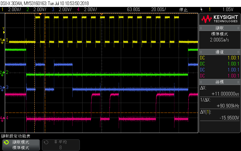

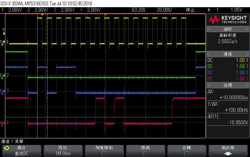

I am using DRV8323 for design.

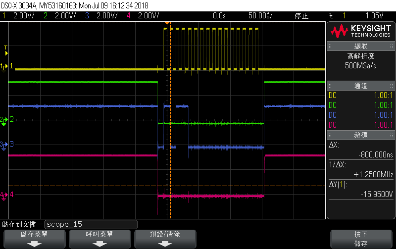

When I was trying to read the data in register 0x06h, the output from SDO become different.
Please see attach:
ch1: SCLK; ch2: nSCS; ch3: SDI; ch4: SDO
the result is get from reading SDO each 1ms
Please help to confirm if this is reasonable, shouldn't it be same result?
thank you.
  • Hi user021864,
    Please note the description of a valid frame in section 8.5.1.1 SPI of the datasheet.
    In your image, the SCLK is high when nSCS transitions from high to low and from low to high. SCLK should be low
    Also the data is propagated on the falling edge of SCLK in your image. Data should be propagated on the rising edge.
    Once these are corrected, please consider lowering the pullup resistor to allow for a faster transition on SDO.

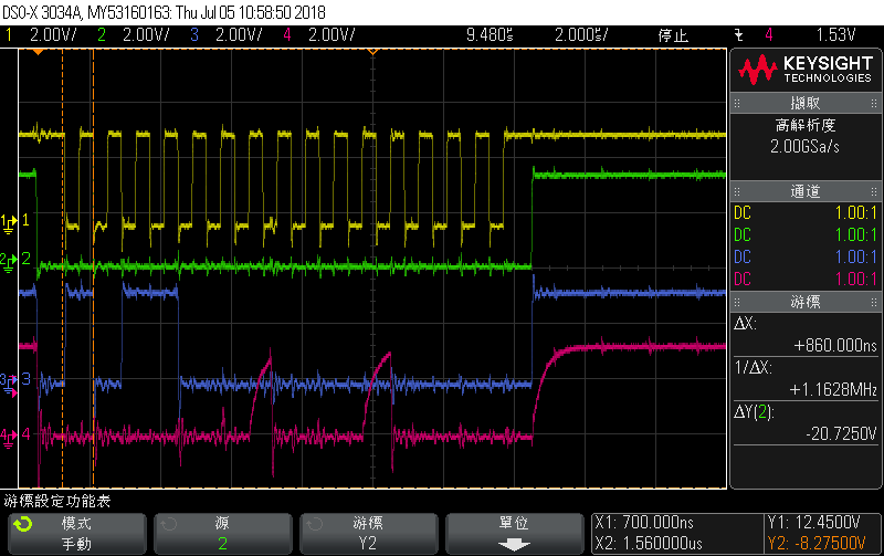

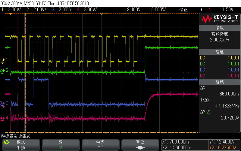

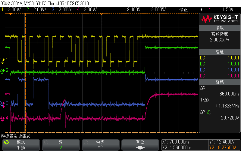

  • Hi Rick,
    Please refer to below attach for the testing result from customer:
    testing condition: read default of 0x06h ; ch1: SCLK; ch2: nSCS; ch3: SDI; ch4: SDO
    when keep reading default value, there are several different result shown in below:
    1. getting result in 283h
    2. getting result in 282h
    3. getting result in 7feh:
    4. getting result in 0h
    Is the problem from reading the value or writing the value?
    The default setting of DRV8323 register should be recover after each power on, is this correct? if not, how to set the register to default?
    Thanks for your help.
  • Hi Howard,
    Yes, the registers are set to the default after each power on.
    Are the registers being written between the reads?
    Please zoom in on the SCLK signal and look for noise. If the SCLK had an extra pulse, the wrong register could be read.

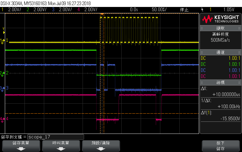

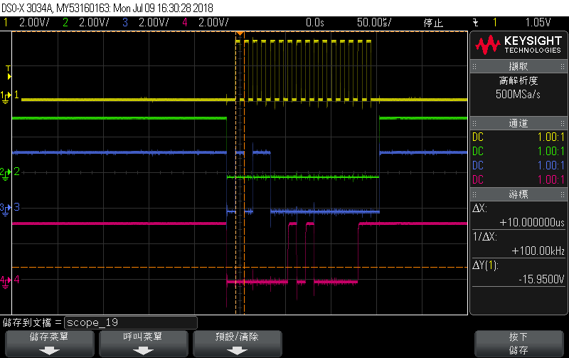

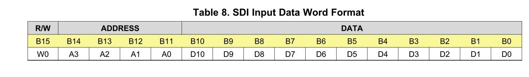

  • Hi Rick,
    Read comment we used shown as follow:
    B0-B10 : 0
    B11-B14 : 0110 (0x06)
    B15 : 1
    it seems that there is no issue of noise, from below reading event:
    1. getting result in 283 :
    2. getting result in 286:
    the result of reading is still changing at each reading.
    May I know what may be the problem?
