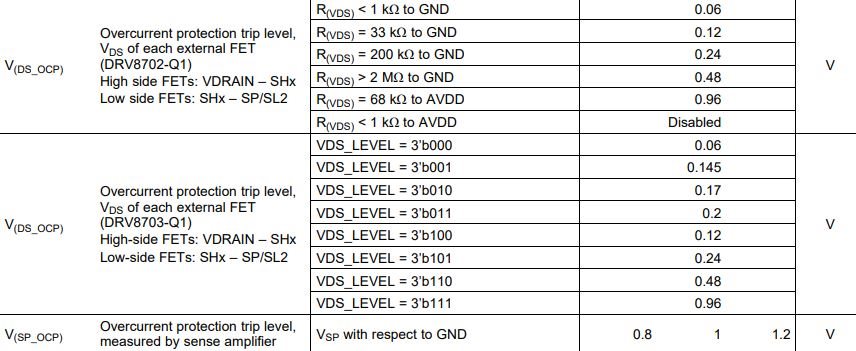

  • Hi Zhivko,
    Please verify by checking what setting you have on the Vds_ocp trip written through SPI (or if its chip default).
    Then you can measure with a trigger in your scope with a differential probe from GH1 to SH1 or from GH1 to SH1 (the latter you must take into account the additional voltage below the switch node).
    That way, you will know if you meet the SPI set OCP threshold.
  • I haven't changed Cds_ocp - so it must be default.
    GH1 to SH1 is 400mV.
    Is your statement correct regarding: " GH1 to SH1 or from GH1 to SH1" - isn't this same in each case?
    Why would chip heat up in case of OCP situation? BEcause as I mention earlier it keeps getting warm - current on power supply show 0.246A bbut only when I connect 3.3V to chip (Vp = 12V is connected constantly).
  • Hi Zhikvo,
    To what pins are you connecting the 3v3?
    The chip does not heat up due to OCP, it heats up due to the amount of power requiring to drive your load or handle the settings you have set. Whatever increases the current load on the bridge and violates your Vocp thresholds. Reducing switching speeds, voltage magnitudes,, gate drive current and the load current can assist in reducing all of this heat. If you know how much current you want your load to require, then calculate based on the Rdson of your Fets what Vocp thresholds you should set.
