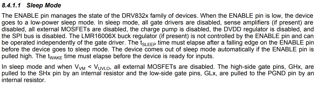

Hi
I would like to ask a simple question. On the datasheet, it is mentioned SPI bus will be disable when the mode is into sleep mode.
Does it mean the SPI register initialize as well?
