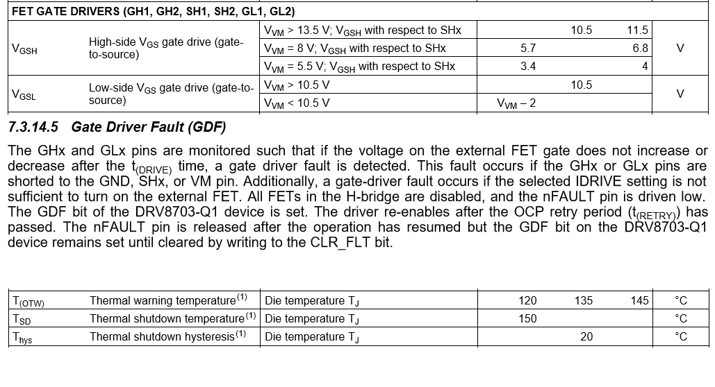

1. GDF.
High-side & Low-side FET Gate deriving voltage are defined on DS.
Are there the voltage threshold on each to judge error or normal after tDRIVE?
2. OTW .

    1. GDF.
    JL: I do not currently have voltage threshold error data available for the GDF feature. The purpose of the GDF is mainly to detect shorts from GHx or GLx to GND, SHx, or VM. Is the customer concerned by a particular condition that makes them ask for this data?

    3. TSD.
    Is it possible to clarify the max. value of TSD? Too higher temperature will create other concern such as degradation.
    JL: Some of our other gate drive devices specify TSD to 185C. That is my initial guess for an upper limit, but I can investigate further if needed. Since the DRV8703-Q1 is a gate driver, it will likely not have a significant amount of self-heating. This device likely will only experience an overtemperature condition if the ambient temperature or nearby devices exceed 150C.

    Regarding #1. GDF, The customer would like to just know the advantage of GDF function to
    select DRV8703-Q1.
    Could you please disclose the criterion of GDF failure or no failure.
    It is no problem if the value will not to be assured like as design spec.
    I am hoping to get your understanding and help, one more time.
    H. Sakai
  • Sakai-san,
    When a gate-drive fault occurs, the driver is not truly controlling the MOSFET. The condition that causes a GDF is a short on GHx or GLx causing the gate-drive current to flow into a path other than the FET gate. In this condition, a MOSFET may be stuck in the ON state, and the motor will not be controlled correctly by the INx pins or the current regulation circuitry in the device. Our driver is able to detect this kind of fault condition and disable the motor so it doesn't burn up if the FETs are operating in an uncontrolled way. The detection method looks for the voltage on the gate-drive output to change while sourcing current into the FET gate. The gate charges and discharges like a capacitor, which causes this voltage change. In the case of a short, this voltage will not change.
    This kind of failure may be a MOSFET failure or a mechanical failure. If the MOSFET is replaced, or the mechanical path shorting the gate drive output is cleared, then the DRV8703-Q1 will resume normal operation.
