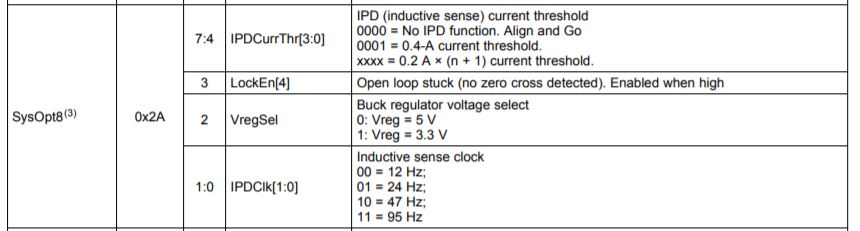

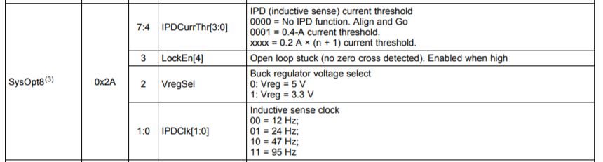

  • Our controller works on 5V, the DRV10983 integrated buck/linear regulator gives either 5 or 3.3 V for powering both internal and external circuit.
            The voltage measured on VREG pin is 3.3V, how can they make it 5V for running there  controller.

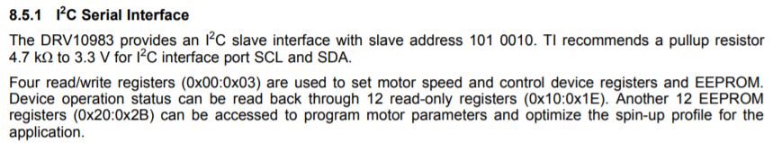

  • We want I2C to communicate with DRV10983, can you please share any example code or how to communicate through I2C.
  • Currently, We are  taking help from SLVUAA5 for using I2C communication with DRV.

    • The voltage measured on VREG pin is 3.3V, how can they make it 5V for running there  controller.
      • There is a register that simply changes the value of VREG, I've copied an pasted the register map below:
    • We want I2C to communicate with DRV10983, can you please share any example code or how to communicate through I2C. Currently, We are  taking help from SLVUAA5 for using I2C communication with DRV.
      • SLVUAA5 is what I'd recommend you'd look at for programming I2C with our device
      • I've copied and pasted our section about I2C below. Generally speaking, I2C needs a device ID, the register value that will be read or written to, and the value (if writing). The pull-ups on the I2C line will determine data that are considered "1's" while "0's" as the determined by the master device (e.g. MCU) by driving the pin to GND. I believe SLVUAA5 gives examples of the waveforms in this context.
