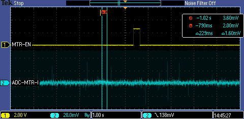

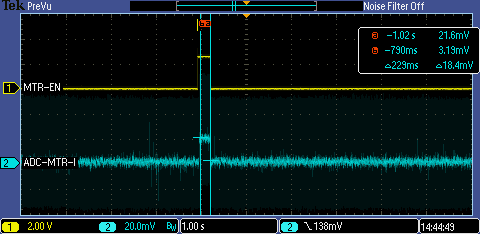

My customer is conducting failure analysis on a unit of their product that is about to go into production.  They see a small amount of current leakage on VPROPI of the motor driver (DRV8850) when enabling the motor but without any motor movement.
The following scope traces shows the motor enable signal (MTR_EN) going high and the current leakage (ADC_MTR_I - this is VPROPI output) at around ~20mV (~122mA):
This event only occurs during reverse direction and not during forward. Furthermore, we used a different board to test this and found no leakage current in either direction:

  • Hi Rick,
    For your question on how many have fail: At the moment 1 out of 500 have been identified. We don't generally check for this issue so it might be present in other units at lesser degree which might not interfere with the normal operation of our system. In this unit, it was significant enough to make it to failure analysis.

  • Hi Martha,
    1. Can you provide more info on the two separate circuits that measure current (forward and reverse)?
    The circuits are similar. The difference is the path of the current. In the forward direction, the current is monitored through the high side FET of OUT1. In the reverse direction, the current is monitored through the high side FET of OUT2.
