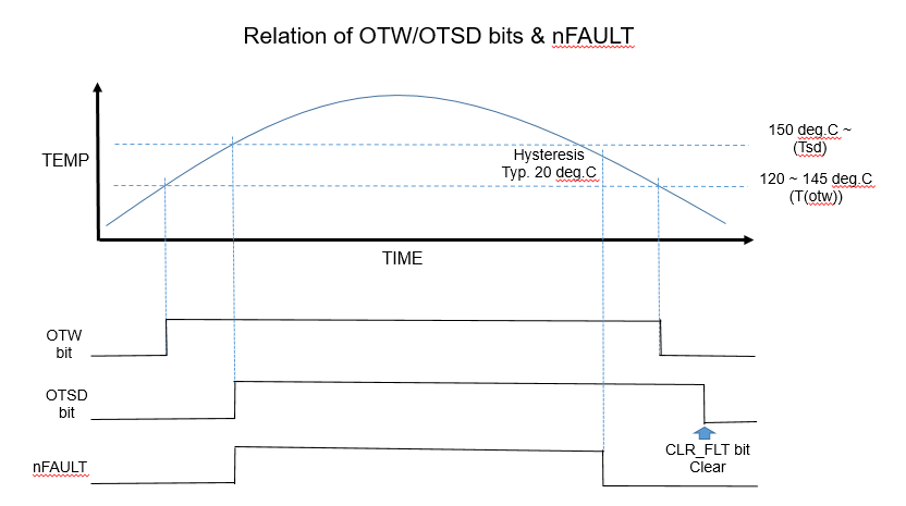

Dear, Sir.
I tried to create the relation of OTW/OTSD bits & nFAULT as below.
Is there my miss-understanding which must be corrected?
Please give your advice.
H. Sakai
Dear, Sir.
H. Sakai
