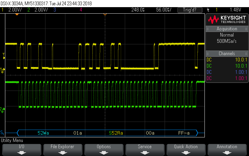

Part Number: DRV10983
I'm having an issue communicating with the DRV10983. I don't seem to get the last 8 bits of the register. anyone have any idea's
Richard.
Richard.
This issue is resolved. the wrong part was fitted to the board not a Q1 part. Some supplier mix up.
Thanks you
Richard,
