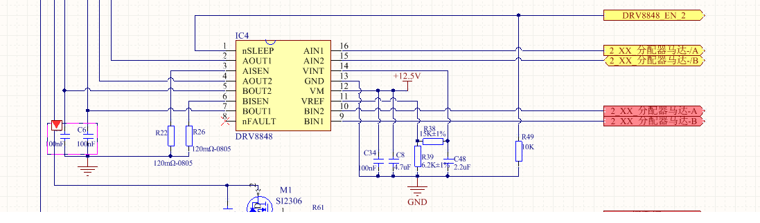

DRV8848: Schematic Review
Part Number: DRV8848
Hi team,
would you please help to review DRV8848 schematic as below? it is appreciated if you any suggestion, thanks.
Kevin
12VM
1.2A current/ch
  • Hi Kevin,
    Here are the comments on the schematic:
    1) Please connect the thermal pad. It is not shown on the schematic, but is needed for proper thermal performance.
    2) Consider increasing the 4.7uF capacitor to 10uF if both motors are operating simultaneously.
    3) Consider adding a connection for nFAULT to monitor any possible fault conditions during evaluation.
