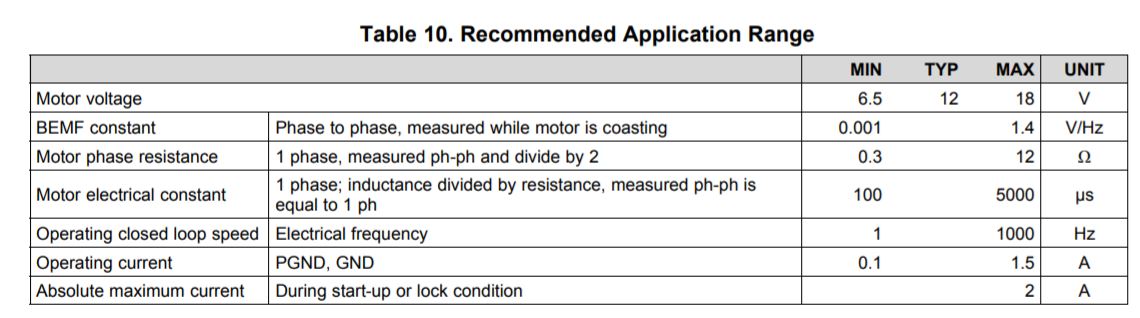

    Assuming the motor parameter falls within the operation range below, use the Kt value to find what the V_BEMF is at the electrical speed of 35Hz using the equation I wrote in my last post. Hopefully, the V_BEMF will be at least 1V peak and mostly sinusoidal in shape; this means there is a high probability that the alogrithm can spin the motor.
    If the V_BEMF is less than 1V, there is still a probabillity that the algorithm can spin the motor but it will be a trial and error process.
