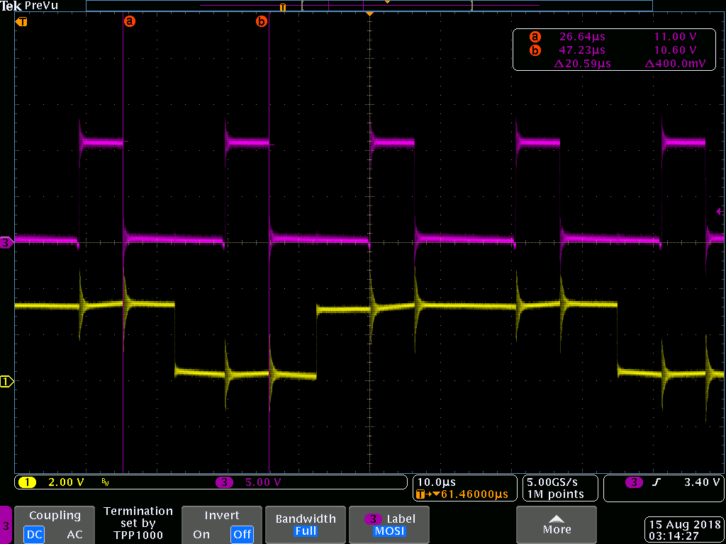

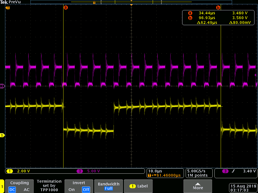

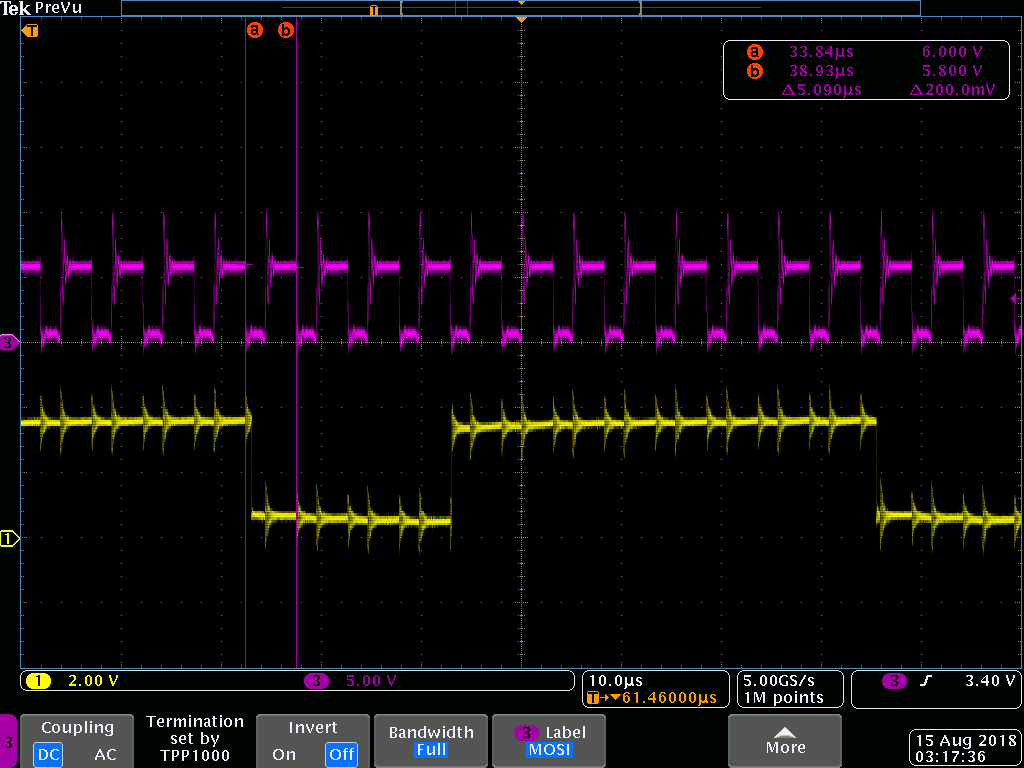

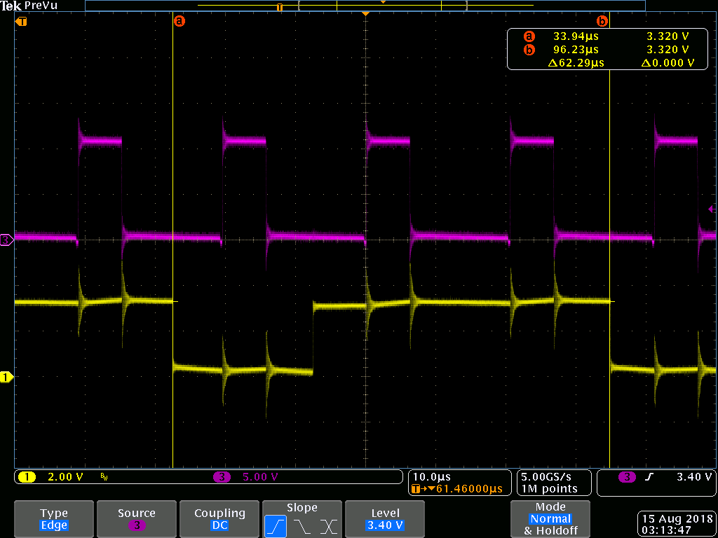

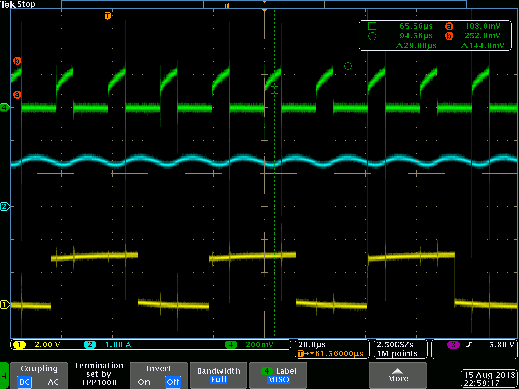

The problem I encountered was this: When stalling a motor with a vice, at a 50 kHz FET output frequency, the duty cycle of the FET output was limited to 30% when using a CLKIN duty cycle of anything above 30%. With CLKIN duty cycles lower than 30%, the output duty cycle matched it as expected. While changing settings, I noticed that a change of output frequency to 200 kHz (with no additional changes) allows the FET output duty cycle to continue to rise to match that of CLKIN until an overcurrent or UVLO condition is met. This behavior is the same in open loop or closed loop speed control for both output PWM settings. I have included pictures below of the duty cycles and power consumption of each mode below. I have also included all of my driver settings at the end of this message.

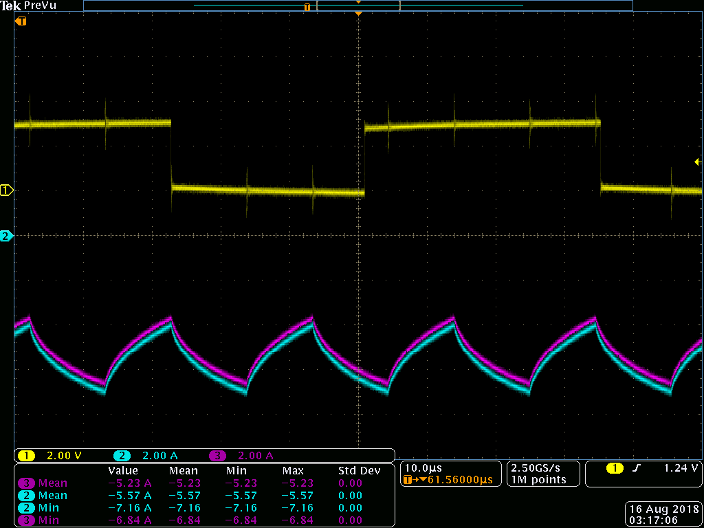

Scope photos:

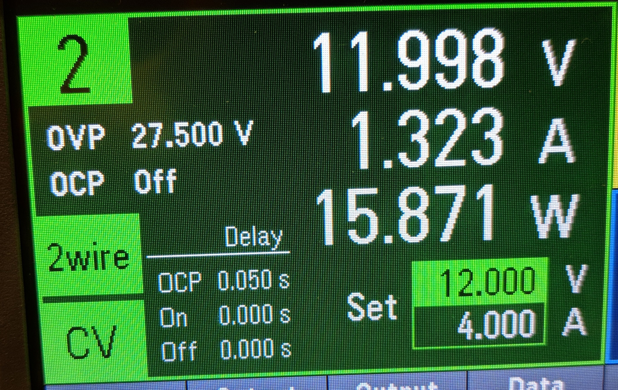

50 kHz FET PWM. CLKIN (yellow) at 68% duty cycle. HALL_U (purple) at 30% duty cycle. Current draw maxed out at 1.323 A.

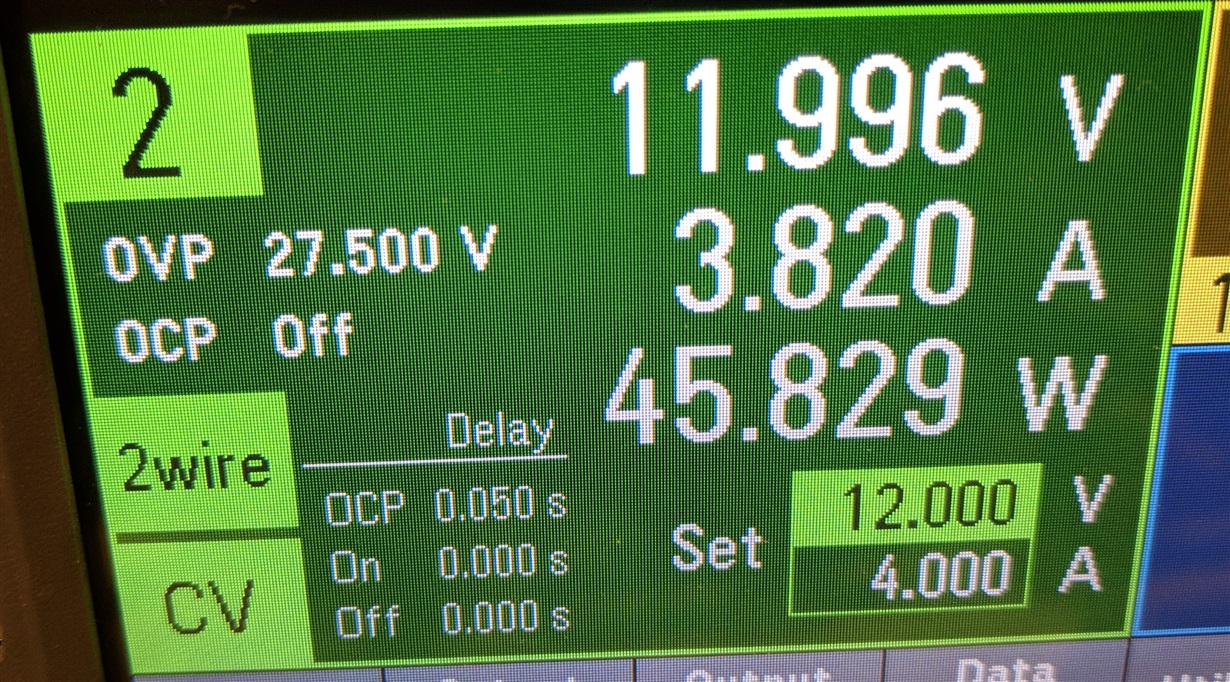

200 kHz FET PWM. CLKIN (yellow) at 68% duty cycle. HALL_U (purple) at 68% duty cycle. Current draw maxed out at 3.82 A.

  • Hi Andrew,
    Have you examined the current through the motor when operating at 50kHz? It may be the current limit is activating and disabling the FETs.
    If the voltage across the sense resistor is exceeded (meaning the current is higher than expected), the outputs are disabled as described in section 7.3.9 of the datasheet.
    At 50kHz, 30% is the tblank time. The current is probably higher than Vlimit/Risense, causing the outputs to be disabled for the remaining 38% of the cycle.
    At 200kHz, 68% is within the tblank time. This means full current is provided.
  • Hi Rick,

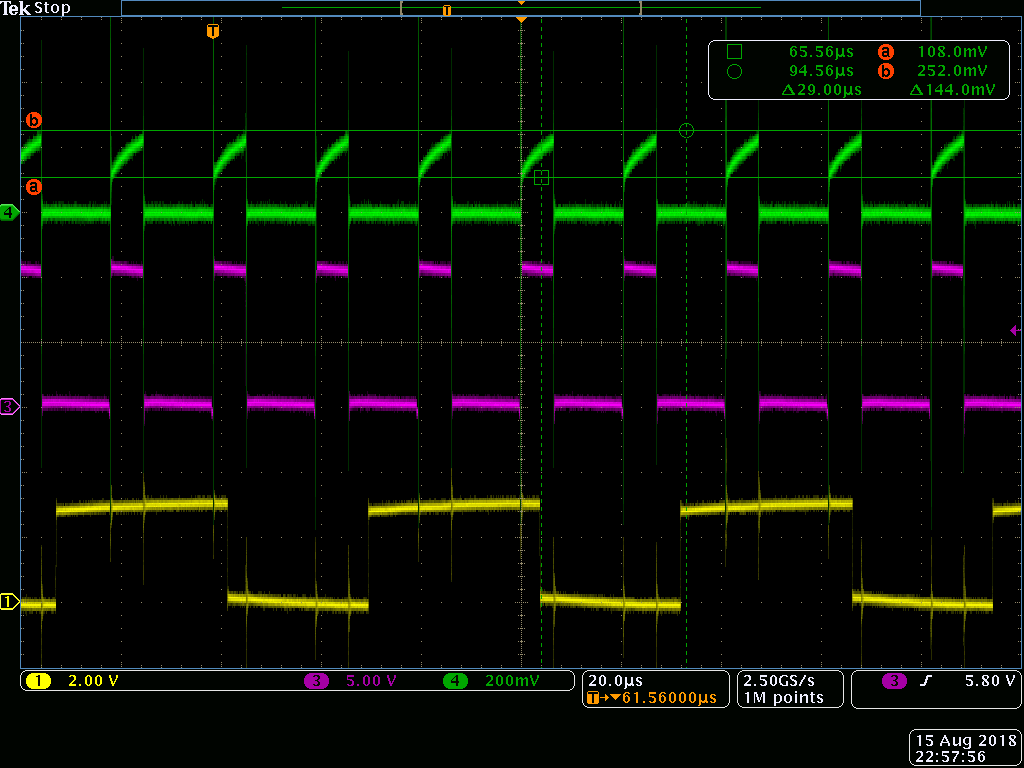

    Thank you so much for your response. I probed the ISEN side of the current limit resistor (set to 43 mOhm), and the behavior matched what you described. The voltage across the Isense resistor rose for 6 us up to a little above 250 mV before getting pulled back down to 0 V (pictures are at the end of this comment). The 6 us blanking time matches up with the duty cycle I was seeing at higher CLKIN duty cycles. I again set up a current probe for the motor supply line, but saw nothing more than a steady 1.3 +/- 0.1 A supply current.
    I put probes on the wires leading to the windings of the motor, and sure enough, the winding current peaked out at about 6 A when stalling the motor. Connecting another probe to a second winding showed that there are always 2 windings with that much current (when stalled) out of phase with each other. Since the two are out of phase, it makes sense that their overall effect would cancel out and not appear on the supply line. However, the current is definitely flowing through the sense resistor and reaching 250 mV at ISEN.
    After changing some configurations settings and resistor values, I found that a sense resistor at 21 mOhm and a cap of a 55% duty cycle at 50 kHz provides an appropriate amount of power to the motor without passing the current limit.

    CLKIN (yellow) at 55% duty cycle, HALL_U (purple) at 30% duty cycle (6 us blanking period), and voltage at ISEN (green) peaking at 250 mV indicating current limiting. 50 kHz driving frequency.
    CLKIN (yellow) and ISEN (green) as before, with supply current (blue) showing an average input current of 1.3 A. 50 kHz driving frequency.
    CLKIN (yellow) at 55% duty cycle, with HALL_U (blue) and inverted HALL_V (purple) current. The current flowing through each coil is in excess of 5 A (mean). This is with a 21 mOhm sense resistor (11 A limit so as not to hit the current limit), but a power supply limited to 4 A output current. The current through the coils is seen across the sense resistor, even though the total current out of the supply does not exceed 4 A.
