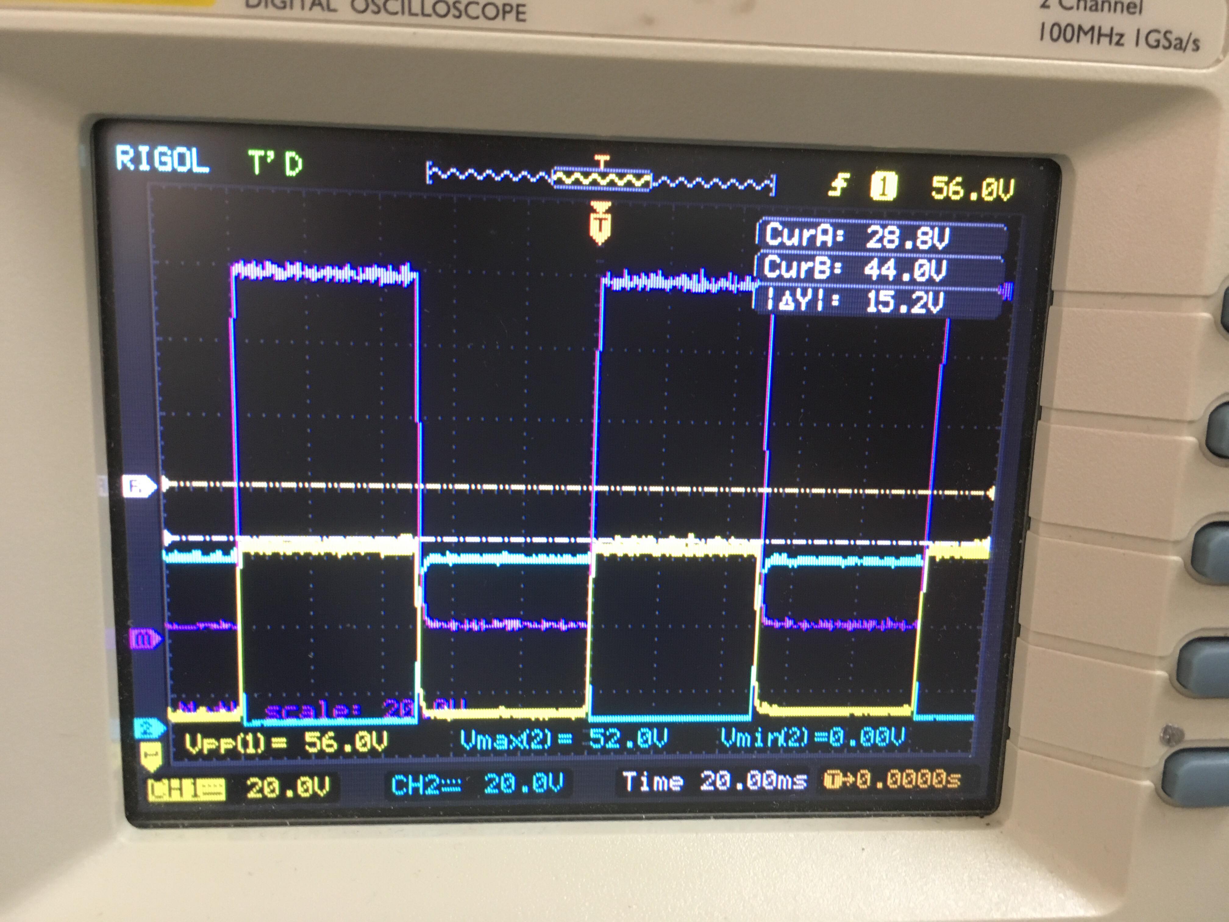

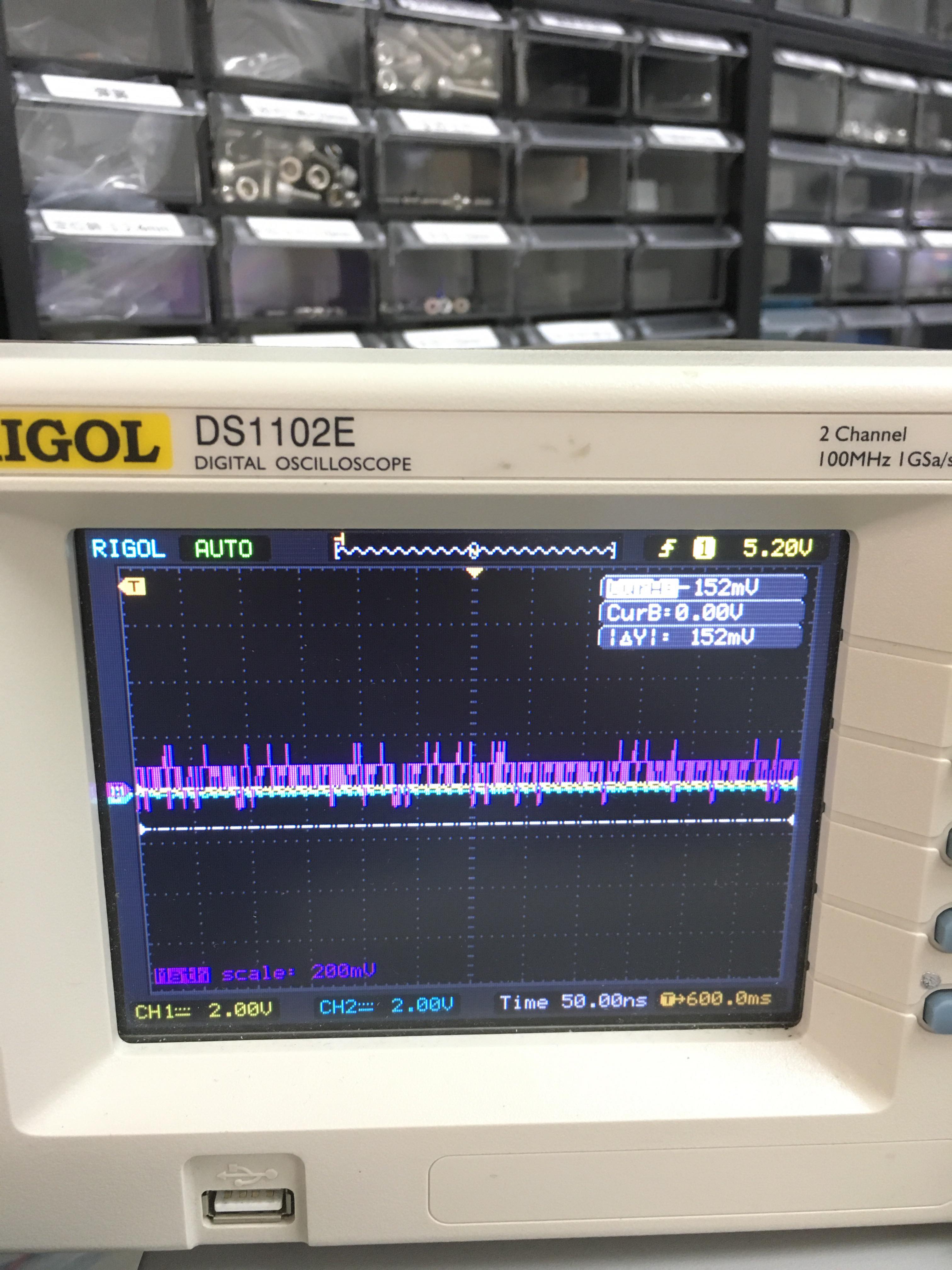

Since we didn’t record the output result of the wrong amplification signals before the circuit burned out, we can only provide the output signals of the rest well-functioning drivers and of the damaged drivers:
The yellow curve represents the signals of Ch1, while the blue curve represents the signals of Ch2.Both the signals show square wave with peak to peak voltage of 50V. The purple curve is the difference of signals in Ch1 and Ch2, revealing a square wave with peak to peak voltage of 100V (50X amplification rate).
        However, the damaged driver shows no amplification, even no output signal when measuring.

  • After review of the above test procedure, there are a couple things I would like to highlight:
    - Square wave signals (PWM) should be used on the J5 connector, in order to use the LPF to take the PWM into an analog-like signal.
    - DC_IN (TP4) should be used only when DC voltage is input to the device to drive the output in a steady state.
    Perhaps the first three devices were able to withstand the direct PWM input but the last one did not.
